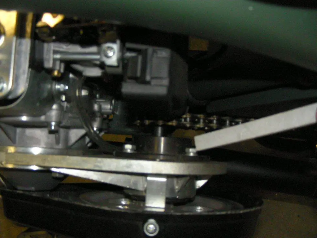

4. You may have to loosen the T Belt loosen the four bolts on the out put shaft SANY0307.jpg now use the spanner wrench spanner.jpg to loosen the T Belt
5.You will now be-able to remove the clutch bell 20tbell.jpg I believe that some thing on the clutch bell and 20 tooth has broken or separated inspect it throughly you may need to replace this part or some thing to do with the 20 tooth.
