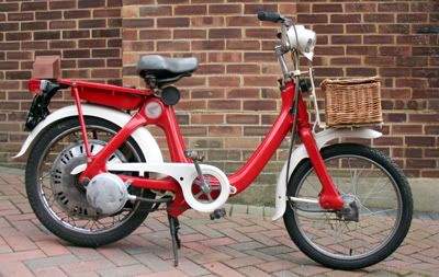

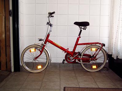

You're saying that this:
without an engine, etc, could in no way be considered a bicycle?
And yet this is most certainly a bicycle...
I don't see much difference, except for the heavy-duty frame/wheels/brakes. I would want them to be heavy-duty, if it was motorized, or if it was carrying 50lbs of batteries.
And yes, if you put the same engine back on, I would call it a moped again; I wouldn't put the engine back on, I would want to put an electric bicycle motor on it instead. I would call what all of the motorized bicycles on this forum are to be mopeds. Of course, I go by the real definition of moped, not what a lot of people call mopeds.
mo⋅ped /ˈmoʊˌpɛd/
–noun
a motorized bicycle that has pedals in addition to a low-powered gasoline engine designed for low-speed operation.
...a motorized bicycle. In other words, it's a bicycle...with an engine. A lot of people like to call my Honda Passport a moped.
I certainly do not. It has no pedals. You have to shift gears. It's not even a scooter, but technically a step-through motorcycle.
Anyway, if a moped is a motorized bicycle by definition, then a motor-less moped is a bicycle, also by definition.
