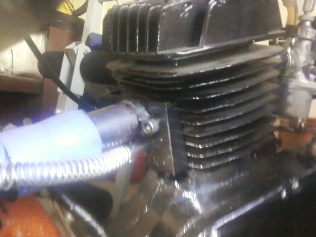

So I got tired of ruining pants because of the oil spraying me out of the exhaust gasket at wot. I tried everything from a copper gasket, to the exhaust gasket sealer, even at a leaner mix i am at (32:1) it still sprayed at wot.
So I made a bracket to block that. Cut a piece of aluminum angle, had to cut the side to clear the exhaust pipe, and drilled a hole to mount under the exhaust mounting bolt. It is approximately 2in long. I put one on each side, had to dremmel down the side facing the left foot when biking because of the slope on the engine block. I must say, this was by far the best cheapest mod I did.
