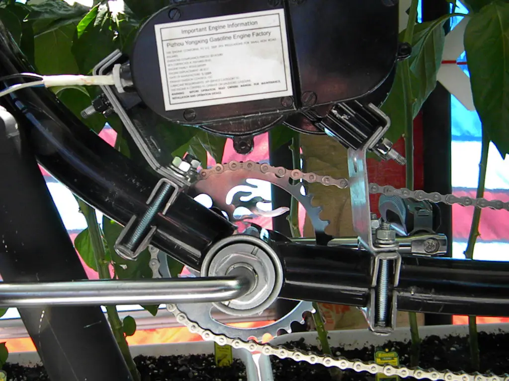

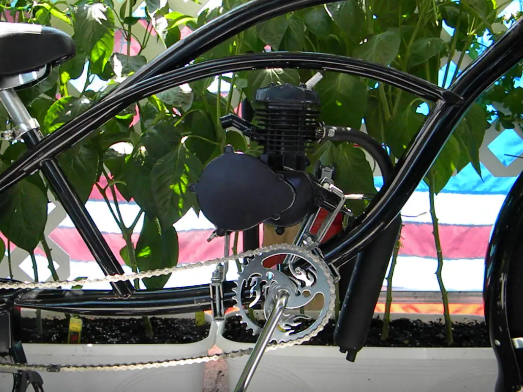

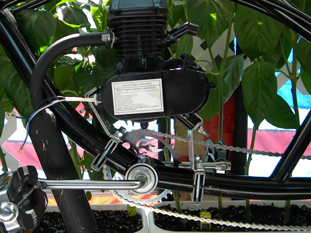

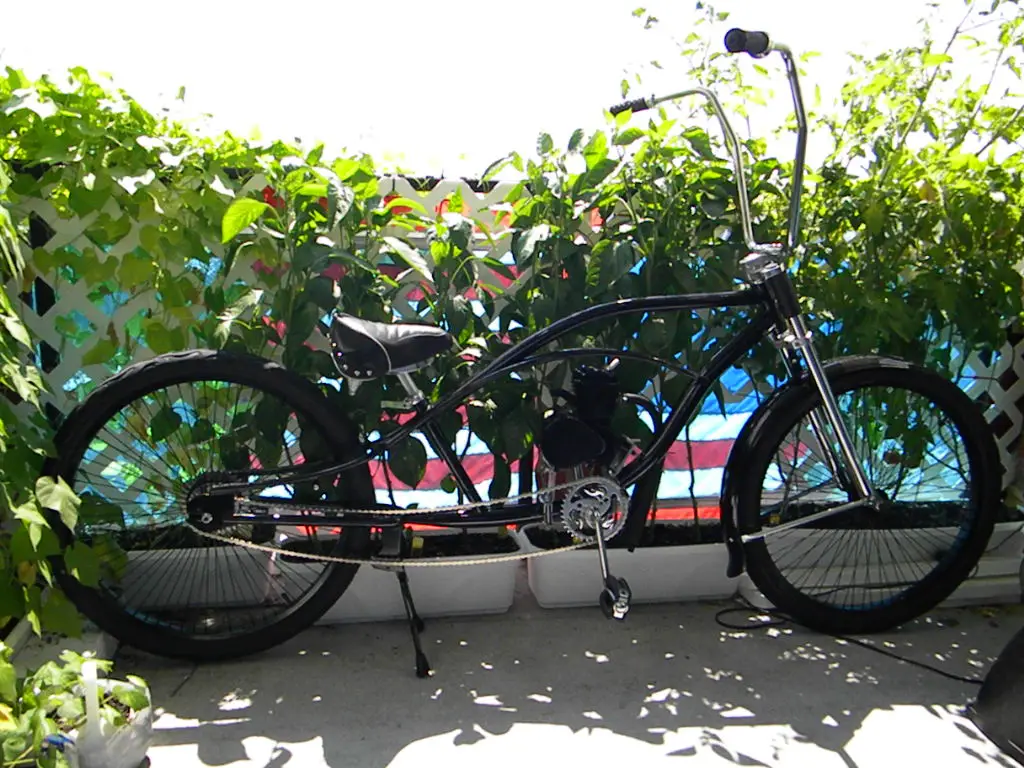

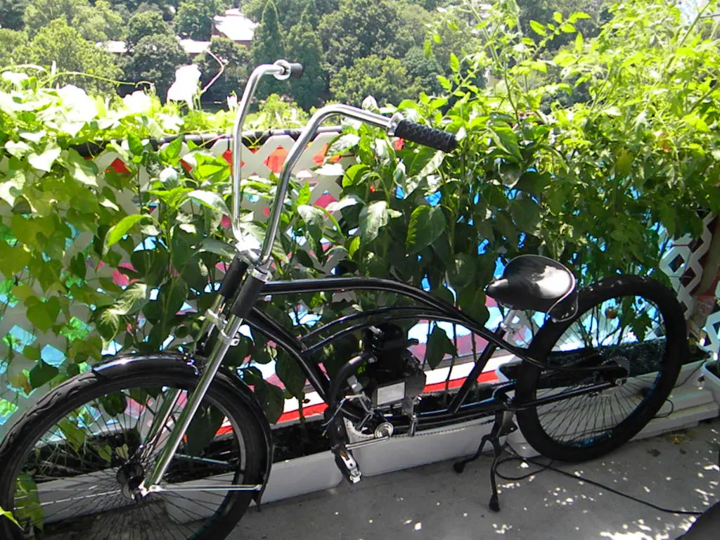

Just wanted to share my new build for a customer of mine here in the Washington, D.C. area.
What a beautiful bike for motorizing the Stretch Cruiser!
My customer wanted a stealth 66cc/80cc motor & he wanted to use the 68 spoke wheels my nightmare begins. ( see post on Wheel Rims )
Motor used is a zoombicycles black stealth 80cc mounted on a black stretch cruiser with ape hangers.
With a rear 36tooth sprocket yes on 68 spoke wheels, I say never again will I use a 68 spoke wheel can you feel my pain ( suffering from 68 spoke-finger-itis )!!!
Motor mounts are a design by RedB66,
atleast as far as I know he's the first to use these type of mounts.
Its a work in progress still need to install chain, carb, clutch cable lever, throttle, gas tank & brakes, paint motor mounts touch up minor scratches from motor installation.
Pic's attached
Peace Crazy Horse.

That angle on the motor may require a different Intake as it will not let the carb sit level. It looks like it is adjustable you may want to tilt down the front a little to get the proper angle
Great looking ride so far I would like to build a stretch cruiser where did you find the mounts?

This reply is a lil late to say the least, I was waiting for the new improved version to be posted by RedB66 here's a link to his new version of motor mounts for large tubed Stretch Cruisers:http://motorbicycling.com/f40/update...nts-15926.html
