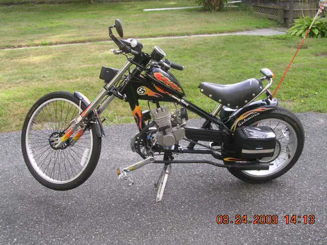

I Have An Occ Stingray With A 80/66cc Engine. It Now Has The Original 44t Sprocket. I Weigh 165 Lbs. I Am Still Breaking In The Engine But The Motor Seems To Be Really Cranking At 20 Mph. The Drive Wheel Is A 20" . I Am Not Interested In Going 40 Mph However Cruise At 32 Would Be Nice.
So What Would The Best Sprocket To Run?

Try a 32 tooth I've heard they work the best for less rpm's and more mph
Nice build btw. I'm doing an occ myself.

go with the 32t sprocket and you will probally get speeds around 30-32mph.

The Manic Mechanic 32T and adapter worked out great comfortable cruise @ 22mph and still climbs moderate hill very well.
