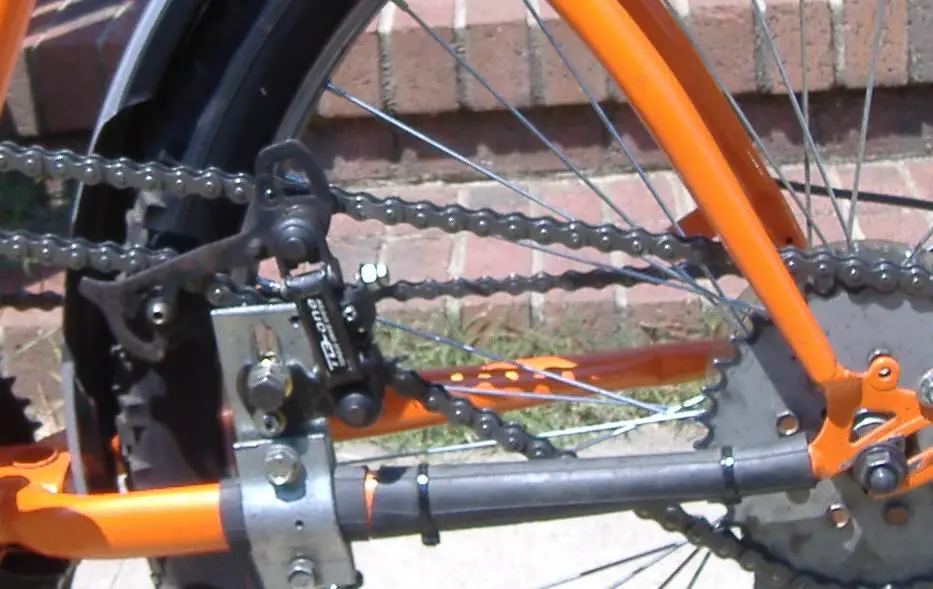

Has anyone considered, or attempted to use a modified Derailer as a chain tensioner? Seems to me it would be the perfect thing, being spring loaded, and could be mounted onto the stock tensioner mount....Just wondering-considering trying just that myself....

Yeah, I have one and I'll never use anything else. They are already proven and road worthy. Check out my thread New OCC chopper paint! and you can see mine

I'm not sure how to post a pic, but I finished a test ride with a modified derailer mounted to the stock tensioner mount, and it works great! Quiet, and a smooth ride....As for me I'm not going back to the stock tensioner-should have done this long before now.

I think I've got the photo attached, sorry about the learning curve on the forum- But I can run my little Moondog to 38 smoooth on flat runs, and am reccomending this mod to anyone who can prep the parts. I found it very simple- here is the pick before flat black primer.
