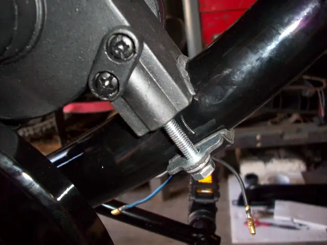

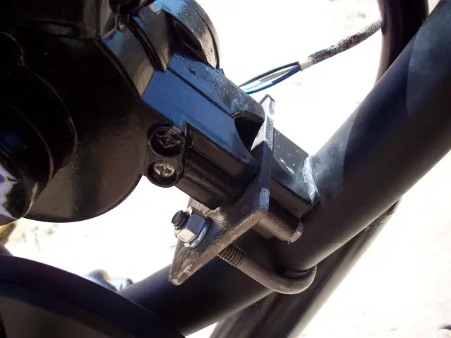

i need to make a front mount,
can i get some specifications on the proses.
thanks.
Old 06-27-2009, 11:59 PM
Dave31's Avatar
Dave31 Dave31 is offline
Location: Tucson, AZ
Posts: 9,392
Default Re: Hello from Chico, CA
thanks.
You must have a motor with the small mount up front because the ones I use bolt right up with no need for a mount. Pic 1
Pic 2 On the smaller mounts we will use a 1 5/8" muffler clamp. We also use a coil spring booster but I do not seem to have any pics of it.
