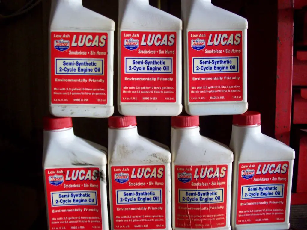

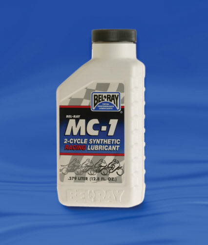

I've used Bel Ray MC1 full synthetic then about a year ago to save money I switched to Lucas semi- synthetic.
I started at 20:1 for break-in and used full synthetic even though some say not too.
After break in I have been running 32:1
