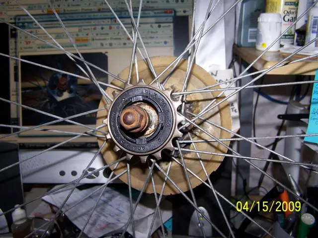

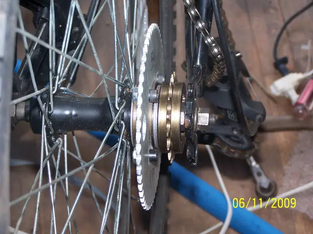

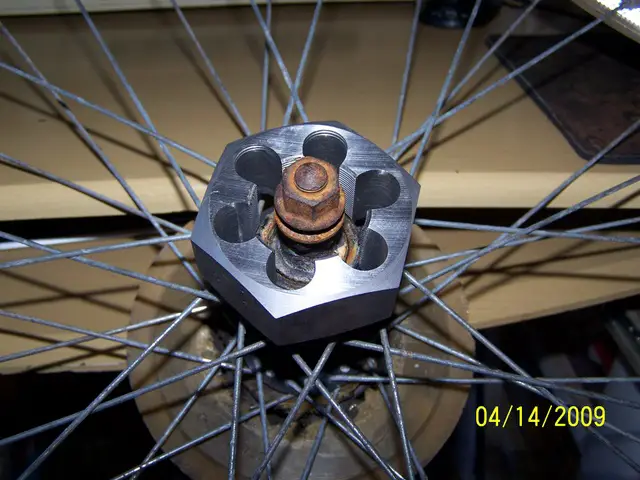

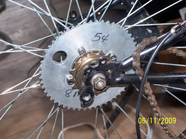

Nashville Kat, I Don`t Think This Is What You Are After But; I Had A Left Hand Thread Die Made To Cut Left Hand Threads On My Bicyle Hubs. Then I Can Screw On A Left Hand Freewheel Adapter Or a Complete Sprocket. Ron .. .. . What you are trying to achive would be great for sure! The 3rd and 4th pics are right hand thread and right side drive

Yeah, that's a start. You had die MADE?
I'm annoyed at standard road hubs, and have wondered if the left side could be cut down to the same diameter as the threaded side, and then even died like this- they seem to have as much clearance off the bearings as the freewheel side-

Your allen bolt sprocket fasteners are interesting- what are they driven into?
also, how do you post these attached thumbnails- they're great!
