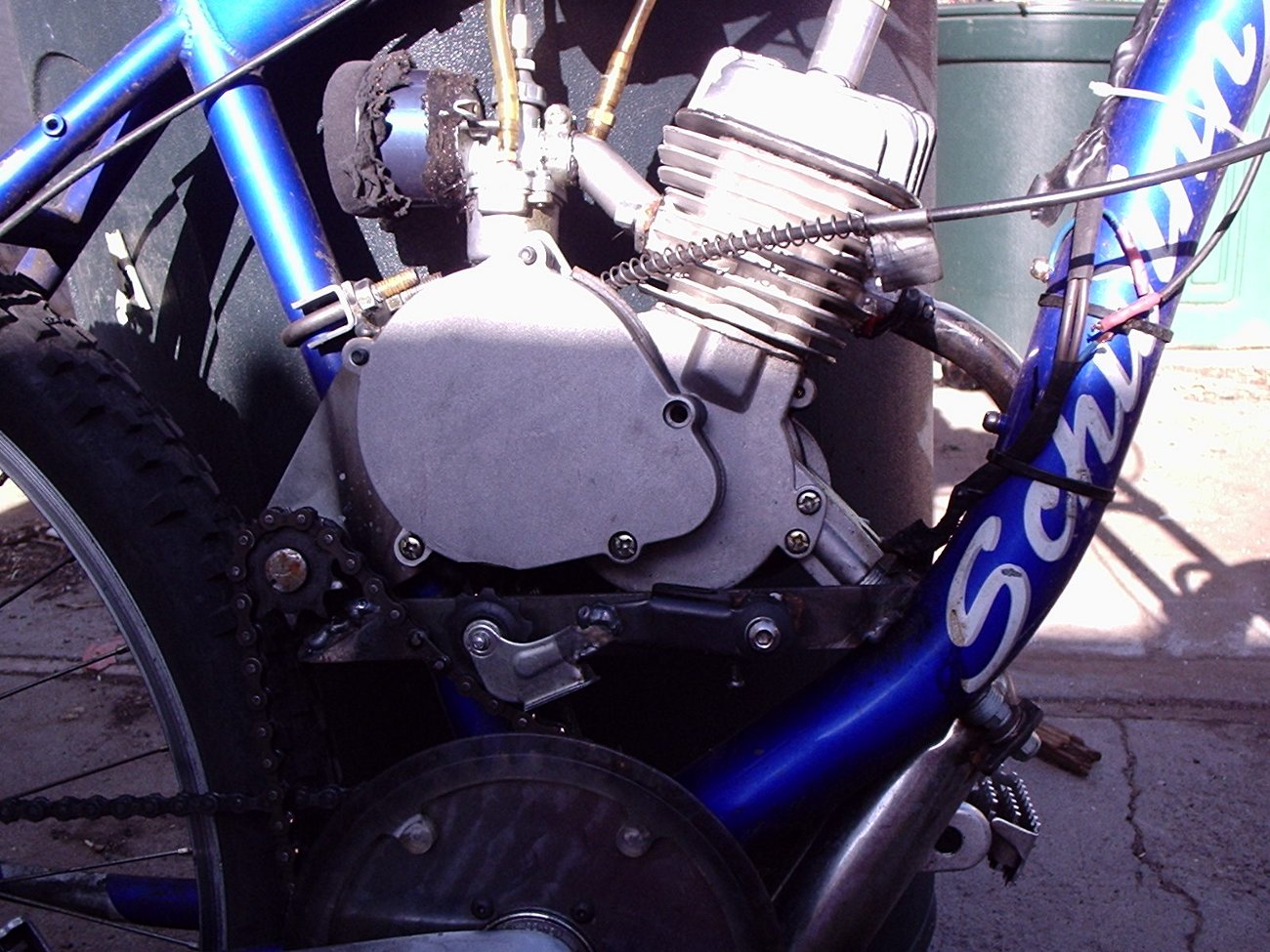

If you guys are talking about this motor 16 to one for break in then 20to24to one after. The last motor I put on a bike did not breaking completely for about 600 miles. They don't get full power till broke in . The carbs are notorious for needing the float adjusted. Thats another story. check the classic bike post . http://motorbicycling.com/f30/motori...cycle-305.html. http://motorbicycling.com/f30/motori...build-302.html. These are very informative. Yes these carbs will spit back a little fuel these two strocks have no valves
