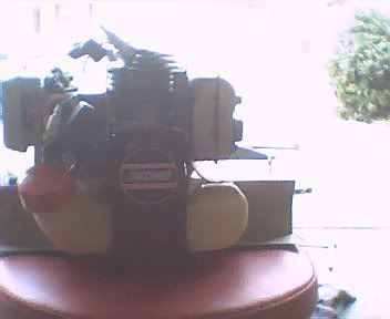

Hopefully i did right and got the pics to post. The quality is lacking but what should i expect from a cam i got for 10 bucks at wal-greens the size of a matchbook. I got ripped off I think. I used photobucket to make the code...here goes nothing

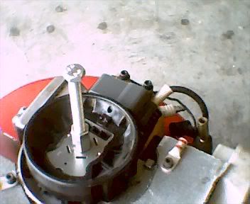

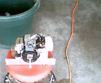

Okay,I know i got to refine my camera and posting skills. Hey,I'm a FNG so I get a break right? Anyway, the top pic was suppose to show how I used the 2 lower clutch housing holes to mount the right angle sheetmetal. I had to scallop out a "u" for flywheel clearence. In the top right hole was bolted an " L " shaped piece that bolts to the bottom bracket using two nuts and bolts. Pic #2 is of the " front" of the engine. The pull starter was retained. Pic #3 shows the 2x4 blocks bolted to the rear,just above the brakes. A little clearence trimming was needed to allow the upright support and brake cable to clear the wood and fit. If you look close notice the door hinge. Its really tough steel. My pa probably boosted it from work ages ago. The last pic I feel is important. I just wish I knew what the coupling came off of. I need a few for spares. The shaft had just enough treads for the clutch to mount to. I used this thingy to secure the flywheel and attatch a 70mm long bolt to allow mounting a drive wheel. If I could find more couplings in metric thread i plan to tap one side to 5/16 thread so i can use a bike peg for a drive wheel. Untill then I will have to make do with what I can find. I got a hole saw kit. The guide will make a perfect center hole. I just have to drill it out to fit the long bolt. 2x4 wheels wrapped in step grip tape. It's the kind thats sticky backed for porch steps. It may work.
Next i have to finish up on the mounting. I plan to use 2 2x4 blocks, mounted vertical like wall studs on each side of the engine and bolting with lag bolts to the bottom flange and the top "arm". I have no metal! The arm will mount to another scrap block bolted to the hinge. The old shaft tube will be cut and flattened on each end to make a sort of triangle brace that connects to the arms end points for stiffness. I'm thinking of using a spring to hold the drive wheel about an inch high off the tire and use an old cable to pull it down from below to apply power to the tire. And yes..I am going to buy a road tire before I test things. The throtle i haven't worked on yet but will get to after i get my mounting done.

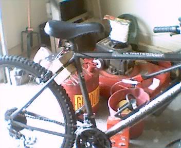

I got back to work on the Hillbilly Deluxe. I finished up the engine mount and scavenged a shelf bracket to attatch it to my "clutch/hinge" assembly. It looks really ghetto but it is actually lighter than I thought it would be and sturdy once I added the muffler bolt bracket. I didn't have a long enough piece of metal to give my airfilter room to be removed so i just bolted it together anyway.I will have to remove the one 2x4 brace to take it off but I cleaned it good before I bolted it up.
While in the garage,head banging to the metal music and cussing some,I realized that if I do another build with this much effort it will be a chainsaw engine or a kit. This is a lot of work for a 22cc engine,but hey,I'm broke,jobless and bored. I do want to do a 70cc kit though one day.
Tommorrow I hope to finally attach the engine to the bike and hook up some sort of throttle cable, kill switch and engagement controls. Friday I will try to change to a rear road tire and find a drive wheel. Oh,i need to replace some fuel line too.
I'm still trying to figure out photobucket...heres my album link of the build if you would like to see pics. I'm trying to figure out how I got the last pics to post.
