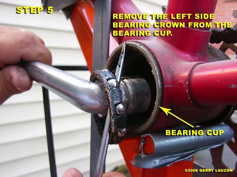

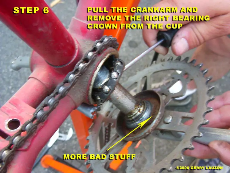

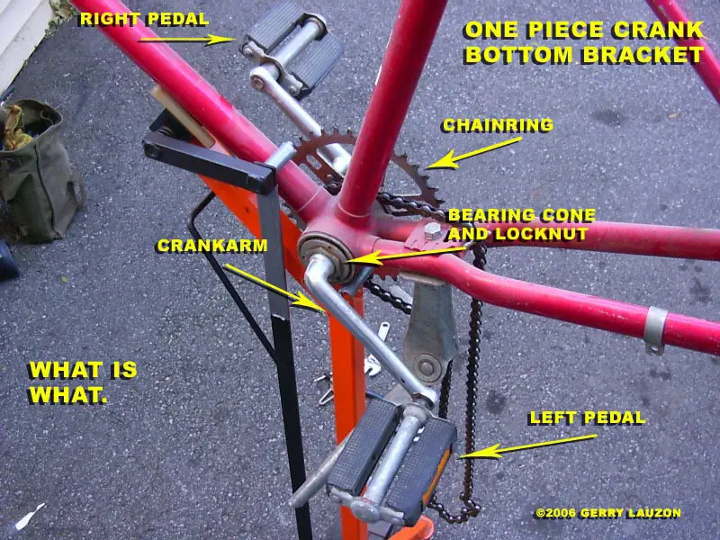

Try this, great pics!

jesus toytime, you are great
that will do it. Great help.
I can clean one and fix the other now.
thankyou very much.
