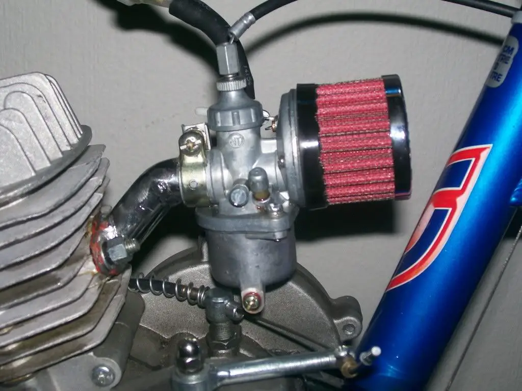

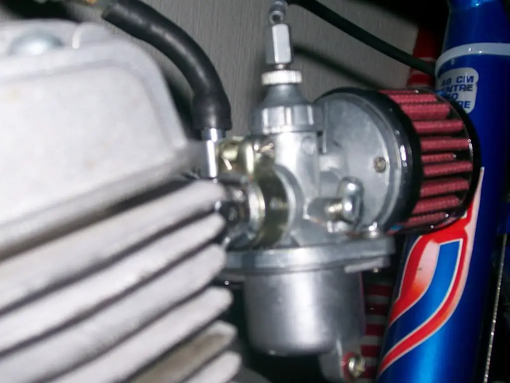

Heres my DIY filter for less then $10aus . I use a oil can/ breather filter from Autobarn and modified the inside to make it fit around the circle groove inside. Using two tiny wood screws to hold them in. Blk silicone around the edges for air tight. Fits great and works Really good!.

o by the way,your throttle cable on top of the carb is loose and not sealed.
you might want to seal and tape it tight.thats called a airleak.
