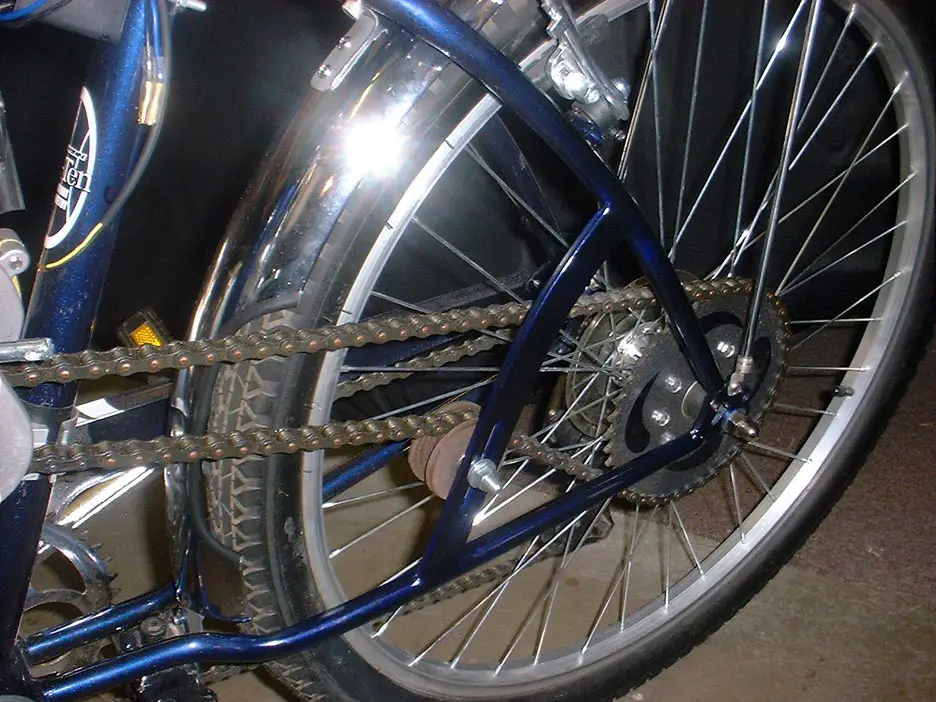

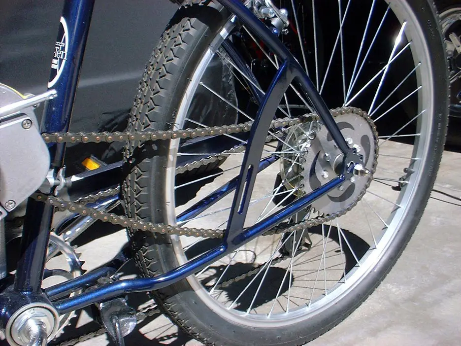

If you're building a Schwinn Jaguar you have to do something to keep the chain adjusted. The Jag has no provisions for moving the rear wheel back. The dropout is just that, a dropout without a slot. I've always hated the looks of the kit supplied tensioner bracket. It's an eyesore and I didn't want one on the Jaguar so I fabricated the one pictured below. I made it from 1" by 1/4" flat stock, machined a slot in it and tig welded it to the seat and chain stays. I found matching paint at the hobby shop, Tamiya #TS-53, model car paint, and repainted the welds after smoothing with some body filler. I use skateboard wheels for pulleys. This set up assures that there will be no movement of the pully and should provide a troublefree way to keep the chain adjusted. I've only needed to tighten the chain on my old bike once in 700 miles but even so it's a good feature to have available.

I like your bracket for your chain tensioner ought to be bullet proof.
My biggest problem is finding paint to match the bike if I weld on it. If I can find the right color paint the 2 bikes that I mounted the front engine bolt through the frame will get a tube reinforcement welded in when I can find the proper color even with the drilled frame I have not had any problems.
