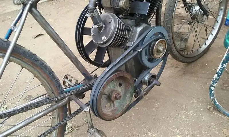

Hello all... after watching Harley and the Davidson's I got inspired to build an old time style motorbike. Here's some video of my Dolphin powered bike.... https://www.youtube.com/watch?v=0oG2RSe3P20

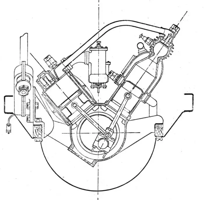

The engine was inspired by the Ricardo Dolphin of 1904. These engines were used to power boats and a car... As far as I'm aware this may be the first Dolphin to power a motor bicycle...
Here's a picture.. http://www-g.eng.cam.ac.uk/millenniu...rdo/page07.htm

Has anyone come across a good theory of operation of this engine. I noticed that unlike a regular two stroke engine, a spark plug in each cylinder, this kind specifically has a cylinder without a spark plug to I guess draw in and ready a charge mixture that transfers to an second cylinder with a spark plug. It idles slower than a normal two stroke engine that is for sure.

Is that an air compressor you modified into a dolphin replica?! It looks convincing at first, then I realized it doesn't look 100% (still, quite convincing though) like the drawing.

So I guess after seeing the post after the first one, I looked for faux. Well guess hose clamps on a rubber hose between cylinders could be OK if it does not get too hot and transfers carb input not exhuast.
Even if it is faux and this is a 4 stroke engine, does the Dolphin 2 Stroke actually idle slow in reality because of the design?

It's still a 2 stroke, the 2nd cylinder is a charge chamber. It just doesn't utilize crankcase compression. If it were a 4 stroke it would have valves. The only valve this engine has is a check valve above the power cylinder.
And I did a little research on that design. There is apparently only one left in existence, and it's not on his bicycle.

It's a converted air compressor (says so in the video header).
That's quite an achievement, getting it to run at all. You guys are nuts!

Hello all, Thanks for the comments... if interested you can read about the Dolphin engine here... http://www.oldengine.org/members/die...sc/ricardo.htm
or here.... http://www.oldengine.org/members/die...sc/ricardo.htm
Ricardo designed it in 1904 when he was just 17 years old... it was know for it's smooth running and high torque.. Around 1908 they made a car called a Dolphin that used the engine... it was also popular in boats.. Never hear of one in a motorcycle though...
The engine operates like any other 2 stroke except that it is uniflow and uses a piston to charge / scavenge the cylinder... I like to build different kinds of engines and I couldn't find any video of a running Dolphin so I thought it would be a neat one to make... yes the engine is made from a 2 cylinder single stage air compressor.. both pistons are on the same crank throw.. I replace the power cylinder with one from a Harley... Agreen, there is actually 2 valves...one near the spark plug and another just behind the carburetor. I've also made some modifications / improvements to the original design like moving the location of the carb and also changed the combustion chamber...
