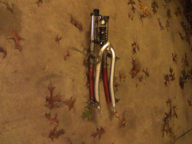

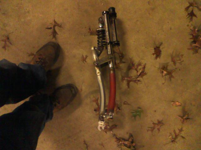

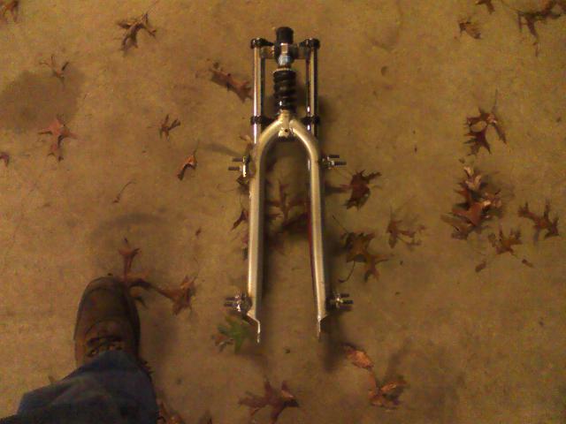

well here is something I made
it will stretch the wheelbase on my cruiser about 2 inches
we will see how well it works
I will use cap nuts with jam nuts & thrust washers, also painting will help
have a great weekend
JAK

I have worksman wheels with a drum brake in the front
its rough fresh off the bench but Ill clean it up
at least you get the idea
the fork is very true
the tire is nice & centered

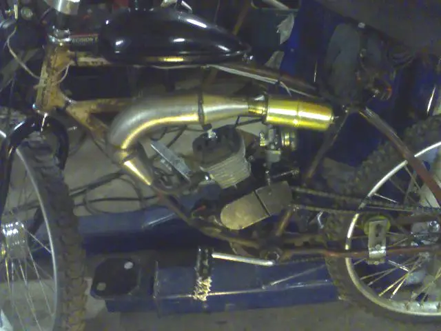

this is the bike it goes on
I may have to extend the fork a bit as with the rake it will lower the front of the bike a little
I hope its not too much caster
JAK

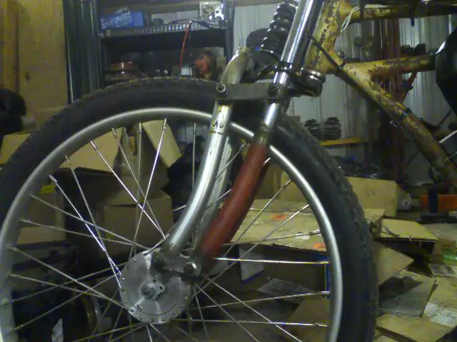

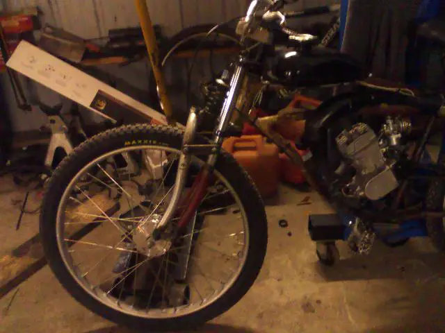

Default well I really wouldent call it sick
it does work really well though
I can feel the weight up there for sure
the spring is too stiff but it really smooths things out
I like the rustic look that the bike is taking on
take care
JAK

That is pretty creative. How is the torsion stiffness as you turn, does it track true and not have give at the hinges? With the motor it does not matter a lot about extra weight here and there in a bike so that could be a really nice riding fork.

yeah it tracks great & I can grab onto the top of the wheel & force it left & right & I only feel the wheel flex it stays strait
it steers slower then the solid fork I had on there but I really like it
I can adjust the hinges to take play out as the fork wears in & have used thrust washers on both sides
this fork would be cool with bearings & parts intended for the fork rather then putting together 3 other forks
