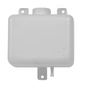

Here is a half gallon tank, for $10. with vented fuel cap (you can seal if you need to).
No joke! Free super saver shipping on Amazon.
Universal Fluid Reservoir, Plastic, White, 6 in. Wide x 4 in. Deep x 5 in. Tall, Universal, Each
This will mount via the bottom tab and one top tab, to the Dax FD tension straps. (you have to drill 2 holes for 1/4 bolts). Since the straps will angle back at about the same degree, the cap will be nearly level. This will keep the weight balanced and down low! Each can will weigh about 5 lb when full. You will have to drill the top of the tank for a small 2 hole weedeater type grommet ($.75 each at mower stores everywhere).

I have been working hard to research this stuff, to give you Dax Friction Drive fans plenty of fuel options! If you are replacing your car to get to work or town, filling up the little tank gets old!
Here is a website for factory direct sales of universal coolant /chemical tanks, nice opaque white tanks with thick plastic and mounting tabs, about $10-15 for tank and universal cap, plus shipping.

See my photo album for more about this. This is a custom made front or rear (preferably rear! It's big, 5 x 10x 6'' )
This will strap readily to conventional bike cargo racks.
You can run it to a NT speed carb or 1/4" ID line barb on any carb with a $1
adapter (look in my album)
You can push the button to relieve excess pressure or vacuum, but you need to use a tank overpressure vent.
