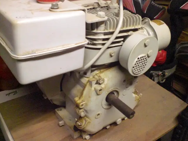

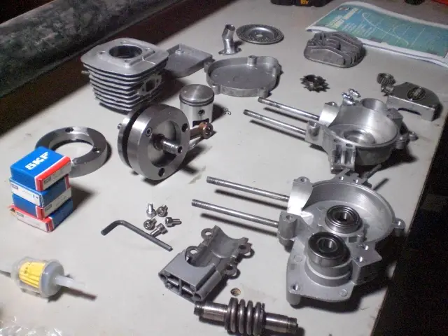

How the work bench looks so far. Look at all those clean parts. Hard to believe that i have been riding it for 8 months

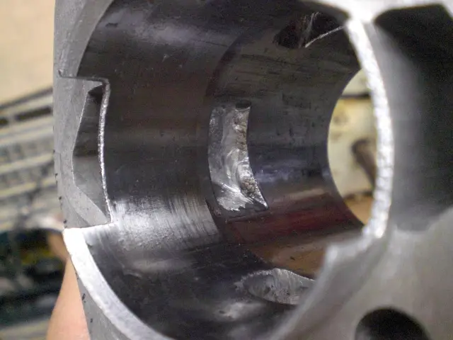

Some things I did today:

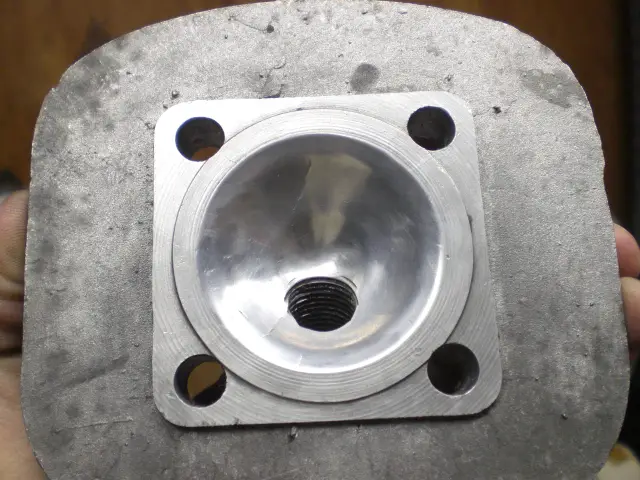

Polished the head (I had already tried it about 200 miles ago, so that is why the before shot doesn’t look so bad.)
Before
http://i1072.photobucket.com/albums/...s/CIMG1236.jpg
After
http://i1072.photobucket.com/albums/...s/CIMG1240.jpg

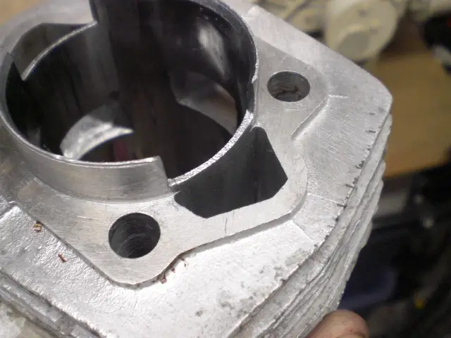

Opened up the transfer ports about 100%
Before sanding with material already removed
http://i1072.photobucket.com/albums/...s/CIMG1213.jpg
After light sanding
http://i1072.photobucket.com/albums/...s/CIMG1214.jpg
Corrected an odd casting defect that was left over from the factory. Im guessing every grumbie has this. It has to hamper performance by a good percentage if left uncorrected. I had to pull a Houdini to get a dermal bit in there without scratch the walls of the jug.
Before
http://i1072.photobucket.com/albums/...s/CIMG1219.jpg
After
http://i1072.photobucket.com/albums/...s/CIMG1221.jpg
http://i1072.photobucket.com/albums/...s/CIMG1218.jpg

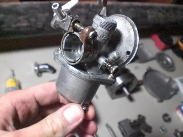

Cleaned the carb up. Left the air filter off because I will be upgrading to a SBP low profile air filter (a million times cleaner and more efficient than stock sponge)
Before
http://i1072.photobucket.com/albums/...s/CIMG1226.jpg
After
http://i1072.photobucket.com/albums/...s/CIMG1249.jpg

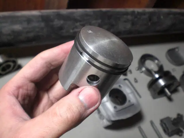

And got a new Piston today (old one had one of its position pins vibrate loose, I stoped it before it killed the jug)
