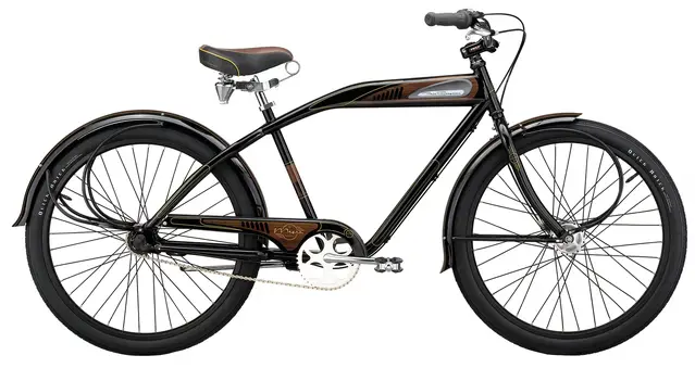

I have been thinking about this build for the last few months and now it is time to start. I am going to be using some parts I have not used before they are more expensive than parts I have used in the past but the quality is higher and over all safer. Here are a few pics
ID:	32823 This bike will get my custom made full length exhausts

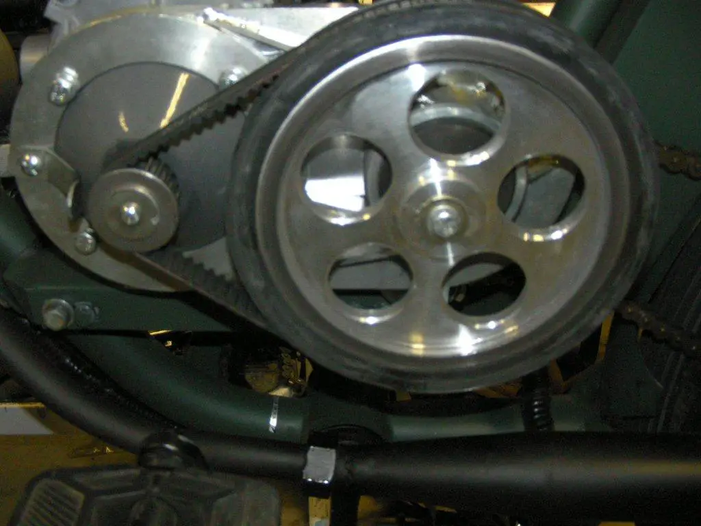

ID:	32817 5:1 ratio 4G T Belt Drive Trans will be modified so output will be belt drive

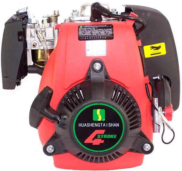

ID:	32818 Huasheng 142F-cc 49cc 4-stroke this engine and trans will get a paint job that I have not done before but is going to be SWEET the entire engine and trans are going to get a paint job it should look well SWEET LOL

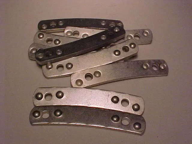

Here are rear sheaves and spacers that are ordered and on the way, same goes for the Strumey Archer stuff it is ordered and on the way too
ID:	32819 I will be using this stainless steel rear wheel sheave

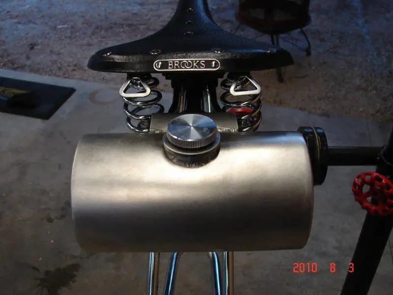

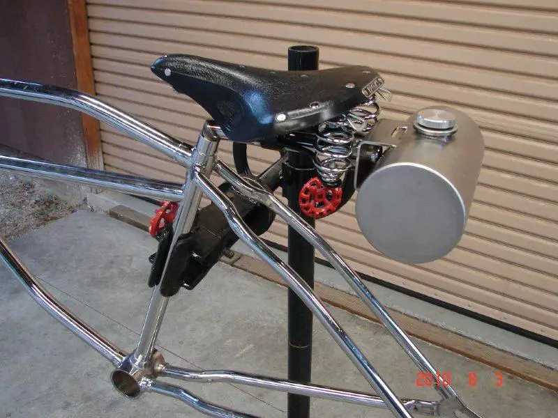

ID:	32821 Because the Magno is a steel frame there is not much room for fuel in the top tube so I will be using this ultra cool tank with lay-back seat post

Thank you I don't see anything that is going to hold me back I Have the sheave for the trans ordered. When that comes in the out put shaft is going to the machinist to have it turned down to 1/2 inch and a key-way cut the rest should NP. I am trying to decide on front forks but that is extra cost and will push the price of the bike up when done we will see shocks would be nice.

why not go with monarch front suspension springer forks and a front fender? would that work well?

just a quick question terry will there be enough clearence for the belt to go through the rear part of the frame?
Old 01-20-2011, 08:03 PM
Terry Blow's Avatar
Terry Blow Terry Blow is offline
Dealer & Custom Builder
Join Date: Oct 2009
Location: Surrey B.C Canada
Posts: 1,091
Default Re: BlowByU Full Belt Drive Felt Magno Build
Ya there is lots of room and if there is not when I have the wheels built I will have them offset
