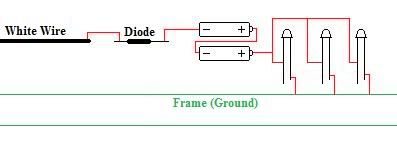

Ok so it looks like I'll want to use two rechargeable 3v LiFePO4 cells in series.
Is this how everything should look pretending they are 6v LEDs?
But back in reality they are actually 3.4v LEDs;
It probably wouldn't make sense to use the Zener diode anymore since I'm using the batteries to limit my power. So my options are wire them in pairs or waste some milliwatts using resistors.
OR, come to think of it... Why don't I just wire the batteries in parallel since I'm only looking for around 3 volts any way?
Would that cause any problems because of the 6+ volts coming off the white wire?
You could try wiring the batteries in parallel (or just use a single battery) but the average charge voltage may be a little too high. But since the white wire coil has a high resistance and produces such a low current, you may be ok. If it worked, that would actually be a perfect voltage for LED lights. And it would make for a simple system. Try it but monitor your battery voltage at first make sure that you don’t ruin the battery. I prefer a 6v system since there are off the shelf 6v components such as turn signal flashers and horns that operate on 6v.
You show a positive ground system in your diagram. I’m not sure about the coil on your particular HT but I use a negative ground system. A positive ground system robs power from my CDI and can kill the engine.
Putting pairs of LEDs in series would make them about 6v. I have not actually tried it. If you do a 6v battery/charging system, it would look more like the following (I included a pair of LEDs as the 6v light).
Hm. In my Diagram the black wire coming out of the motor would also be attached to the frame, is that still a positive ground system? I added the motor and CDI to the pic. I thought a positive ground system was where you hooked the + side of a battery to the frame so it was always hot. I'm just trying to use it to end the circuit of my LEDs
I'm confused about your diagram. It seems like the high RPM 12+ volts would still be getting to my LEDs (unless the fuse burns out)
The black wire attached to the frame is a ground. The coil is also grounded internally. Whether it is positive or negative ground depends on the direction of your rectifier diode and which pole of the battery is grounded.
I don’t know what your diagram is trying to do. You have not grounded either pole of the battery. The battery, the charging circuit, and the lights, should all be parallel circuits. You have all three in series. You are positively grounding the batteries through the LEDs. You don’t show the direction of the diode. You have no switch to shut off your lights.
Try adding a light switch into your diagram and then it may be more obvious why it is wrong.
In my circuit, the lights are parallel with the battery so they only see the battery terminal voltage of 6v. The battery absorbs any excess voltage put out by the white wire at higher rpms. The only way for the lights to see 12v in my circuit is if the battery terminal voltage were 12v. It won’t happen with the feeble output of the white wire. I originally used a zener diode to protect the battery from over voltage charge conditions, but found that it is not needed with the white wire, as even a 1ah battery can absorb all the output of the white wire.
