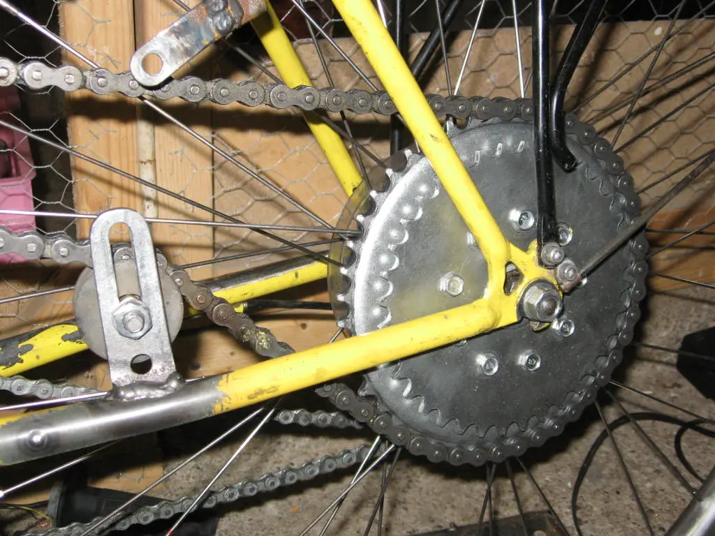

Or you can use both 36 and 44 in a easy way, like i have done
Hey max350, great idea youve got there. Ive just one question though. How are you switching between the two? Do you switch them by hand, or do you plan on creating some sort of derailleur?
Thanks,
Hz
Old 09-13-2010, 03:12 PM
max350's Avatar
max350 max350 is offline
Join Date: Apr 2010
Location: Sweden, Örnsköldsvik
Posts: 95
Default Re: Sprockets?
Thanks,
Hz
Hey! Its fun that you like my twinn sprocket idea. Yes i switch it by hand, just take away some links(or ad) and adjust chain tensior. At this moment i have 36 for highway drive and have change to 48 for driving in the woods. I have no plan for changing spocket when i am driving, i think its to complicated, its not as simpel as change gear on a bike!
