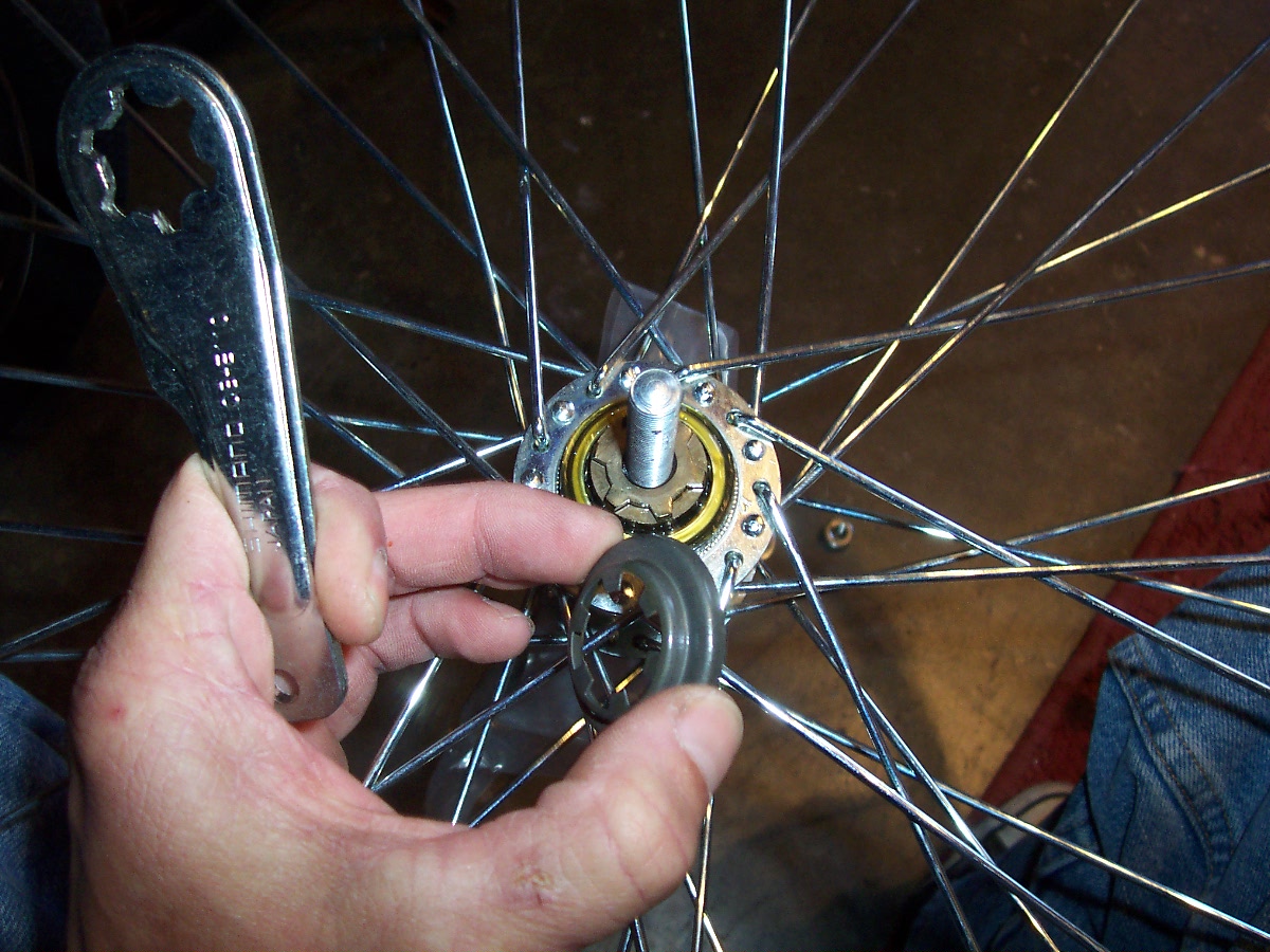

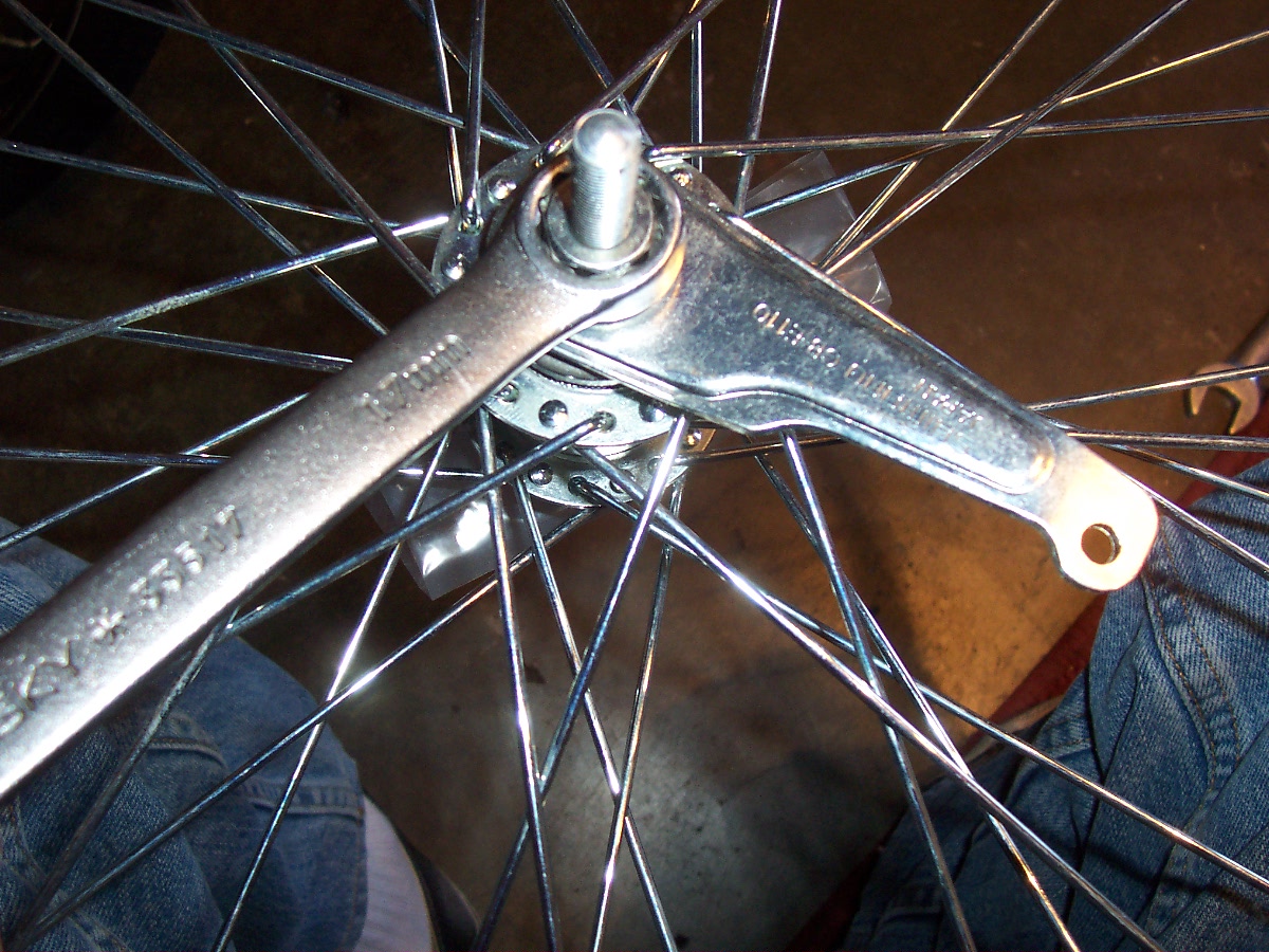

I see this asked over and over, and I'm tired of typing it, over and over, so I made a pictorial.
it's so easy, a child could do it. (I should know, I rebuilt my first coaster brake hub when i was ten)

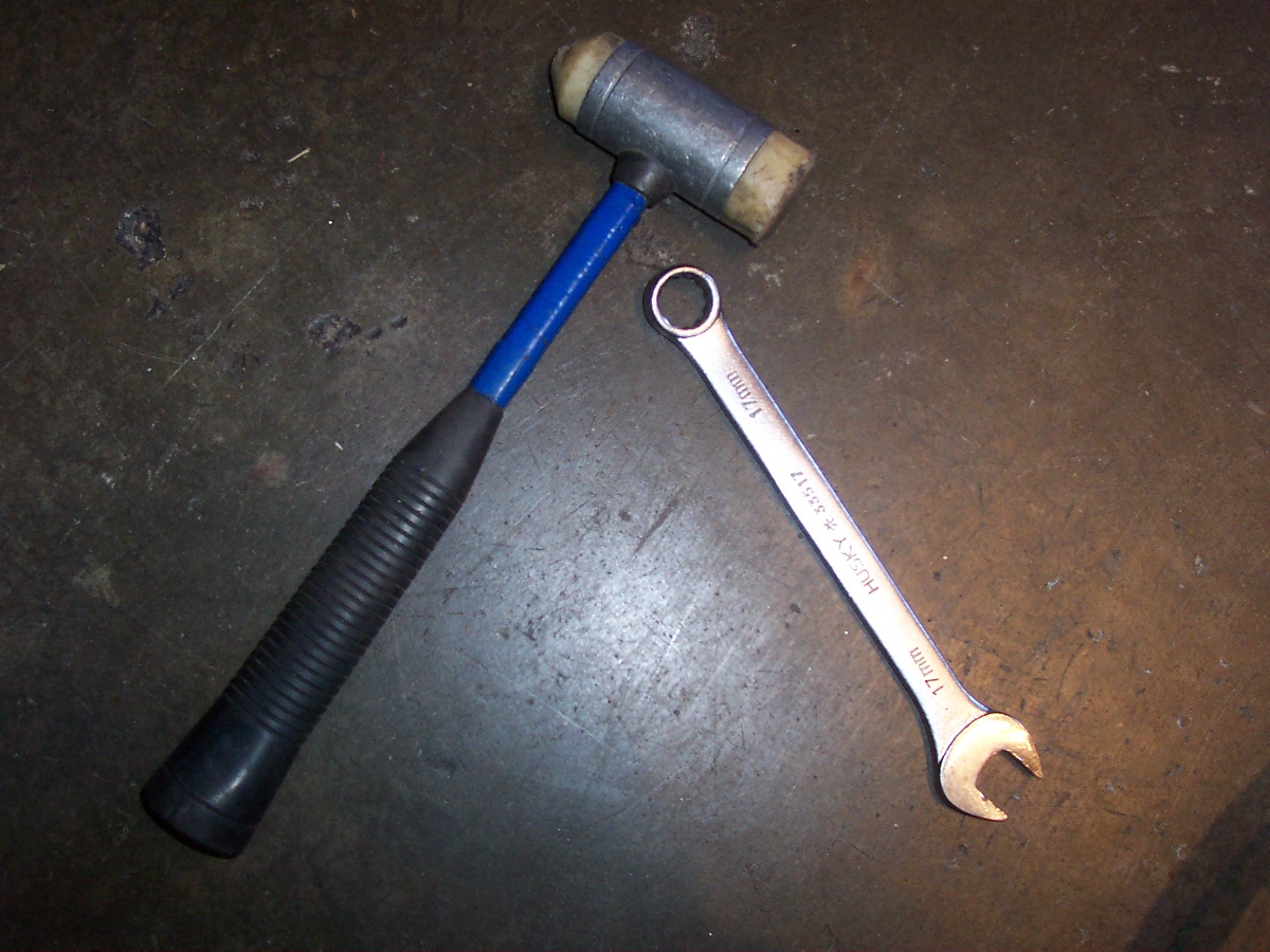

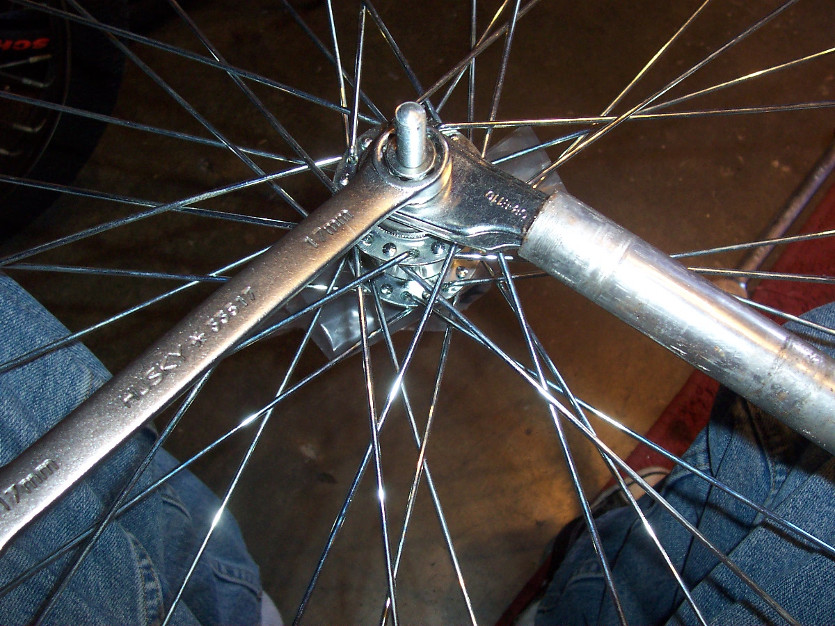

step 1) set the wheel in your lap, coasterbrake arm up, and set the arm in the 4 O-clock position.
step 2) put your wrench on the nut in the 7 O-clock position.

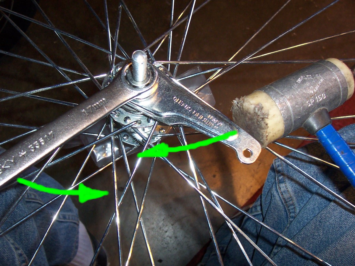

step 3) hold the wrench in your left hand, and using a hammer (or a pipe or a bigger wrench as a lever,) whack (or lever) the brake arm towards the wrench (clockwise,) while moving the wrench counter-clockwise.
it should loosen right up.

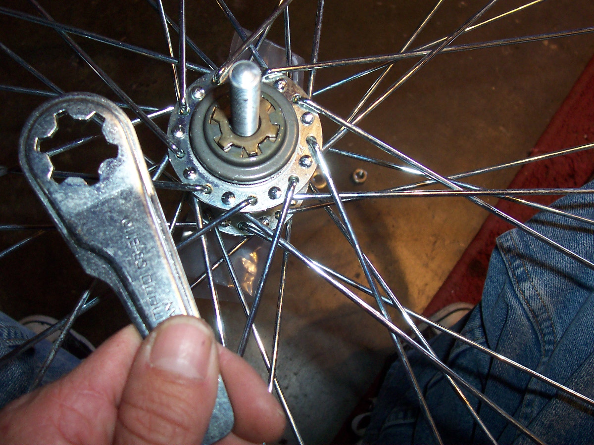

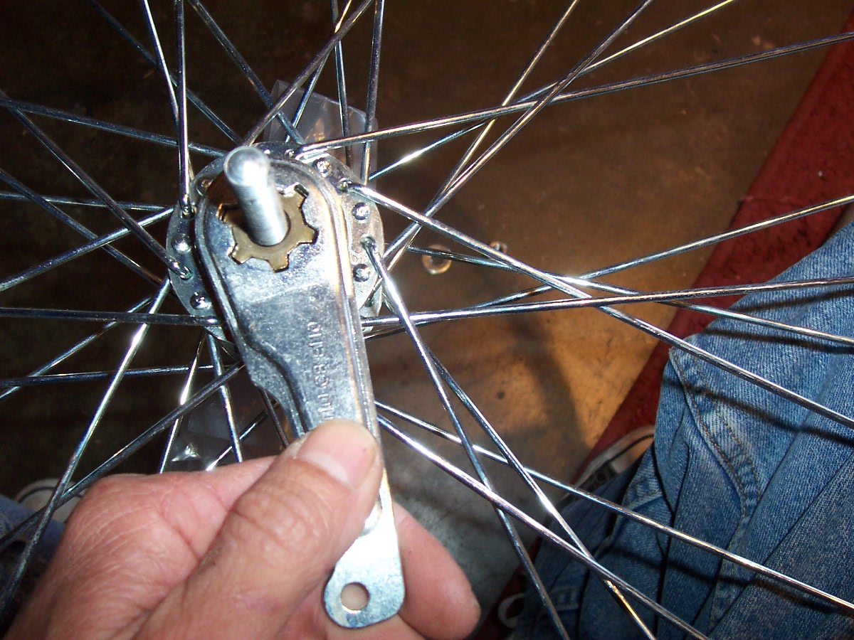

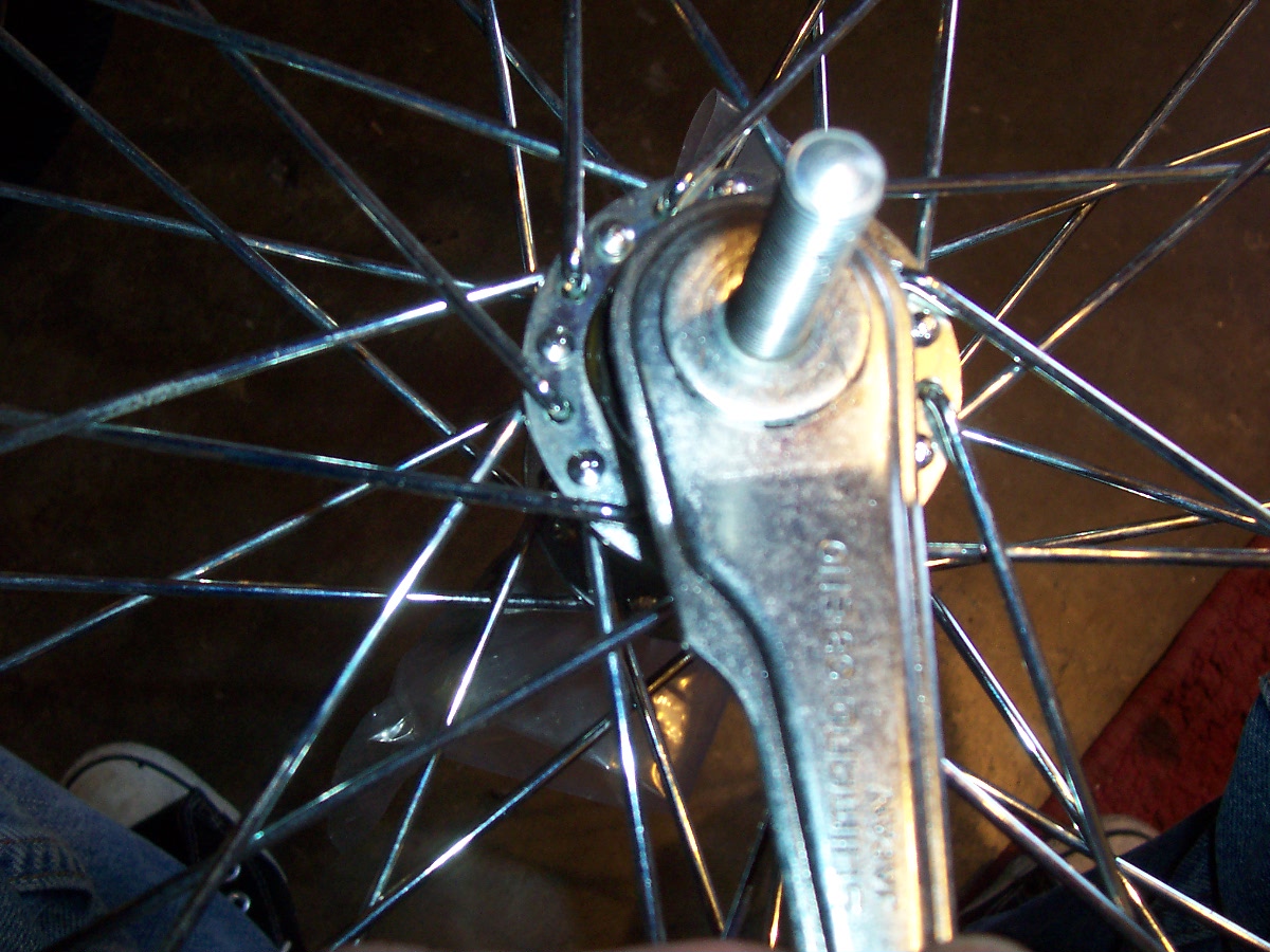

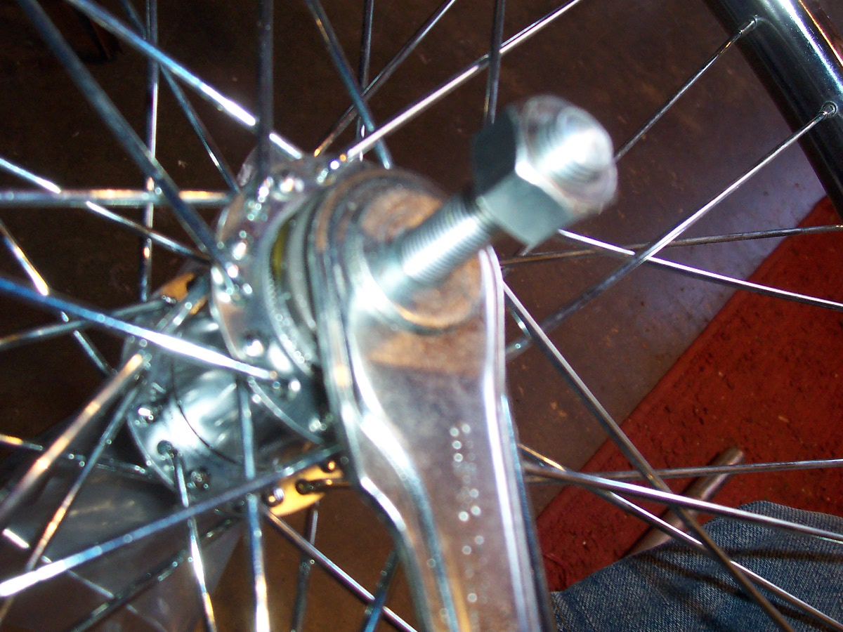

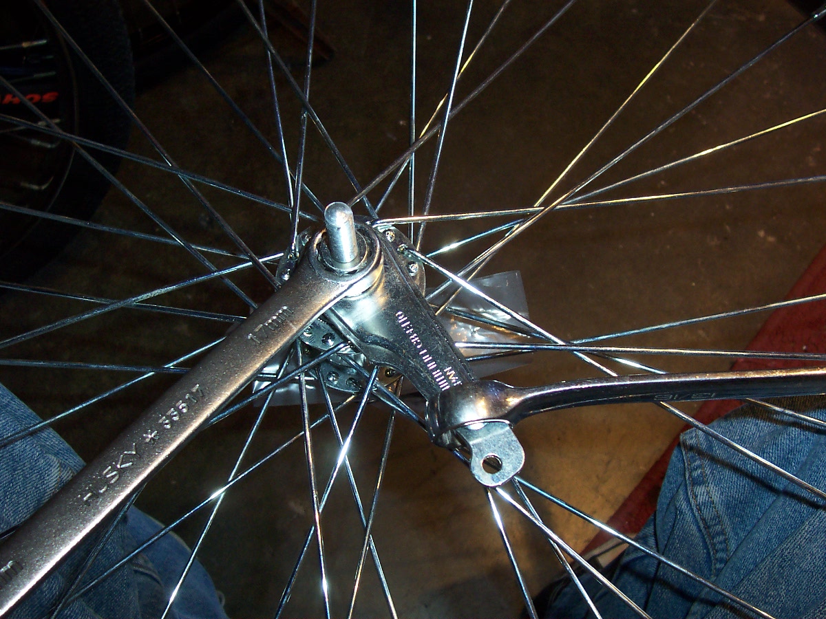

take off the outer nut, the washer (if it has one) and the arm comes right off. you might have to wiggle it a little, but it'll come off.
there's a dust cap underneath. on some hubs, you have to modify this for the stock sprocket.

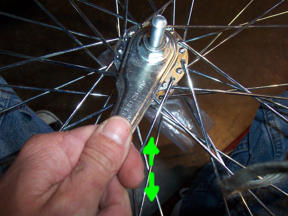

when your arm's back on and tight, wiggle it up and down and check for free play. you don't want any.

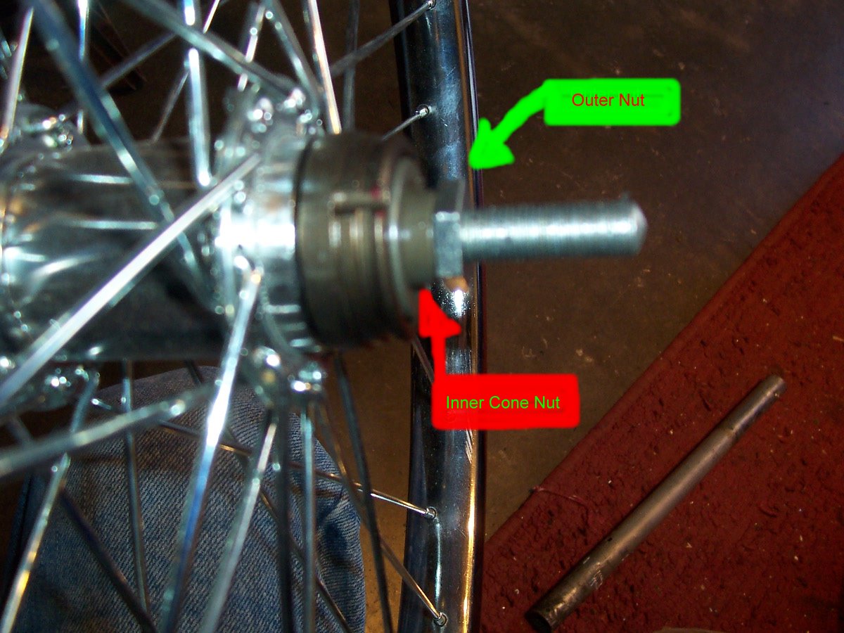

if there is either of these conditions, you need to adjust the cones. this is easiest from the other side, IF you have cone wrenches.
there is the cone nut and the outer, lock-down nut. you need to loosen these up, then tighten the cone nut by hand till the wheel has NO freeplay, yet spins easily. it's possible, trust me.
then tighten the cone nut just a little bit more so there's some drag, and put the outer nut on.
you need to hold both wrenches and tighten them together. 99 times out of 100, the cone nut will move against the outer nut, that's why i had you tighten it to get some drag.
