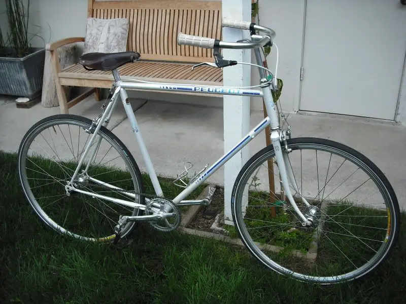

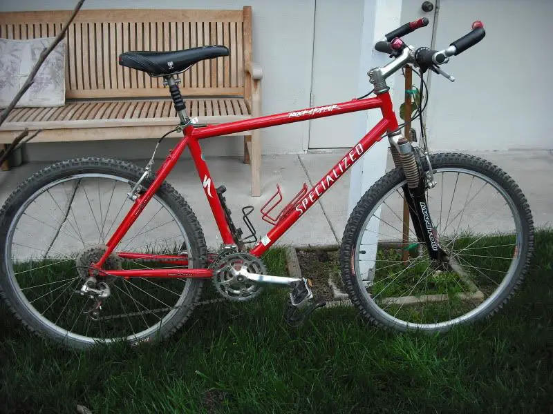

I've got a garage full of bikes: road bikes, 3 mixtes, old road frames, one mt. bike. But none seem ideal (aesthetically) to convert to a frame-mounted 2-stroke.
Is this Peugeot single-speed even a candidate? Or should I stick to the mt. bike? Based on prelim measurements, I can fit a 2-stroke kit in either main triangle. I prefer the old Peugeot, but I have not seen a single conversion done on a typical (old) road frame. If you've got links or photos of examples, please enlighten me. Anyway, I'm interested in opinions, pro and con, between these two.

If you are a big guy, use the Specialized because of the sturdier wheels and stronger brakes. It's also the best choice for rough roads.
If you are average sized, the gaelic steed should work fine. The Peugot also has rack mounts on the rear dropouts.
They are both nice steel choices for a motorbike.

My opinion is, go with the fat tires. There are many factors to consider, better absorption of bumps, if you go off the shoulder because some moron gets too close, the skinny's will cause a sure wipe out. If you see a cool trail you may want to explore, you'd be able to with the Specialized. My two cents...

I put my road bike away after diving off road to avoid danger. Go with the mountain bike! Yeah, front spring fork too

Yeah, I was thinking the brakes would a bigger deal on a motorized bike, and those V-brakes on the mt. bike definitely have more stopping power, especially with good pads. If I convert this one, I'll probably replace the bar with something more laid-back.

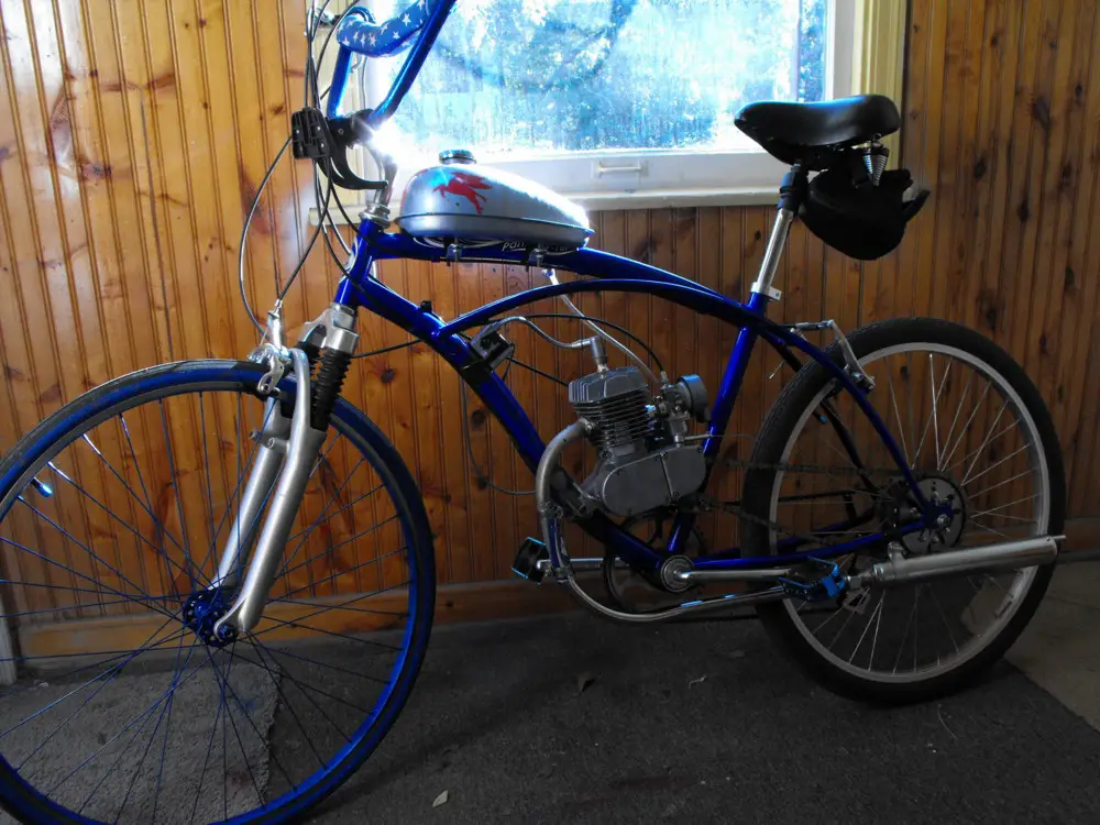

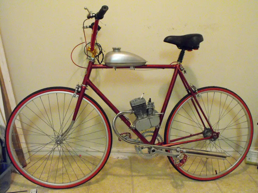

I've decided to abandon the Schwinn Traveler build here for a couple of reasons-
stay clearances are tight- nothing that couldn'tbe overcome, but annoying,
but mostly I found that the short road bike top tube puts the tank in the way of normal pedalling- the whiole hope of the project- so I'm selling this and putting the motor on a Huffy frame I got, and selling the Traveler, which is no match for my Peugeot PX10 regular peddler..
But I'm putting large narrow light wheels on the cruiser bikes- because I want an easy pedal and good rolling for the motor too- not so much for speed, but to less strain it.
The MX bars on the schwinn also make the tank go back another bit, because they protrude in sharp points at the ends, and dent the tank- I just didn't like the feel of the road bike with the motor, the short wheelbase is a bit squirrely, my knees are bowed out to clear the tank, although I could make that better. But I had some snags with a narrow chain and cog before I really got it rolling. And I raced USCF road races for 14 years, so I sorta hoped a road bike would be better with a small 50 cc and with total weight in mind.
The poo poo pipe didn't fit either, so that's it cut, modified with beer can aluminum, and put on the cruiser.
The mountain bikes have verticle dropouts, so I don't like that, but haven't built one up. After a couple of bulds and a year later now, I'm favoring cruiser frames with narrow light wheels and tires-
for the street riding transportation I want-
the other pic is the first build- yet to have back wheel converted to 27 x1 /1/4- just haven't had the time or health, but just about ready to start up again.
so anyway, that's been my experience
good luck

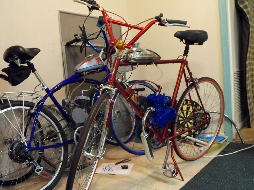

Also- one more thing-
the large flange hubs generally don't fit the sprocket rag joints- I fashioned one of my own sprockets from a 34 MX crank sprocket that hasn't proven very strong.
if you have a sprocket with the six disk brakes holes cut closer to the center hole, you may be able to bolt that right to a large flange alloy hub, but it depends on the pattern of holes already in the hub.
It looks like your Peugeot has a large flange hub to deal with.
Anno blue doesn't look that good on the motor does it?
