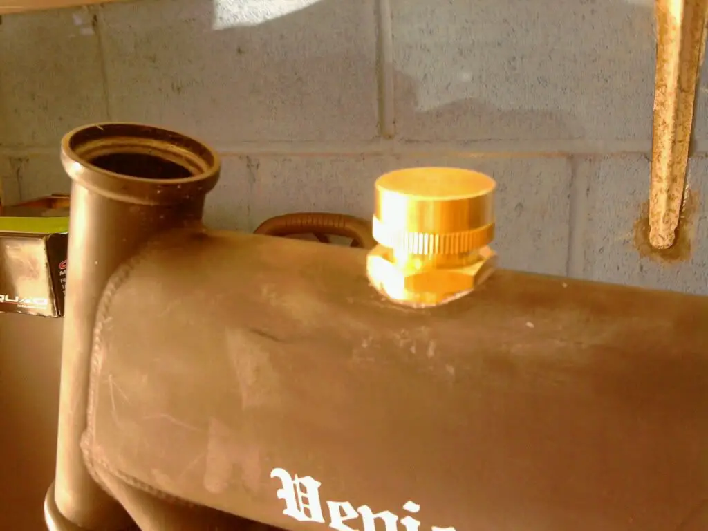

On my Build Off Bike, I used solid brass garden hose attatchments, & I drilled a #71 hole in the center of the cap to vent... It came out looking real nice!
This pic is before it was finished.
jay sawdust
Aug 11, 2009
55
kauai,hawaii
Very nice tank and cap....i don't know where but i once saw a cap on a vintage bike that had a small (probably copper) tube sticking up from the center of the cap and had a complete round coil ending up facing down.....this so gas dosent splash out i guess....Just an idea......J
