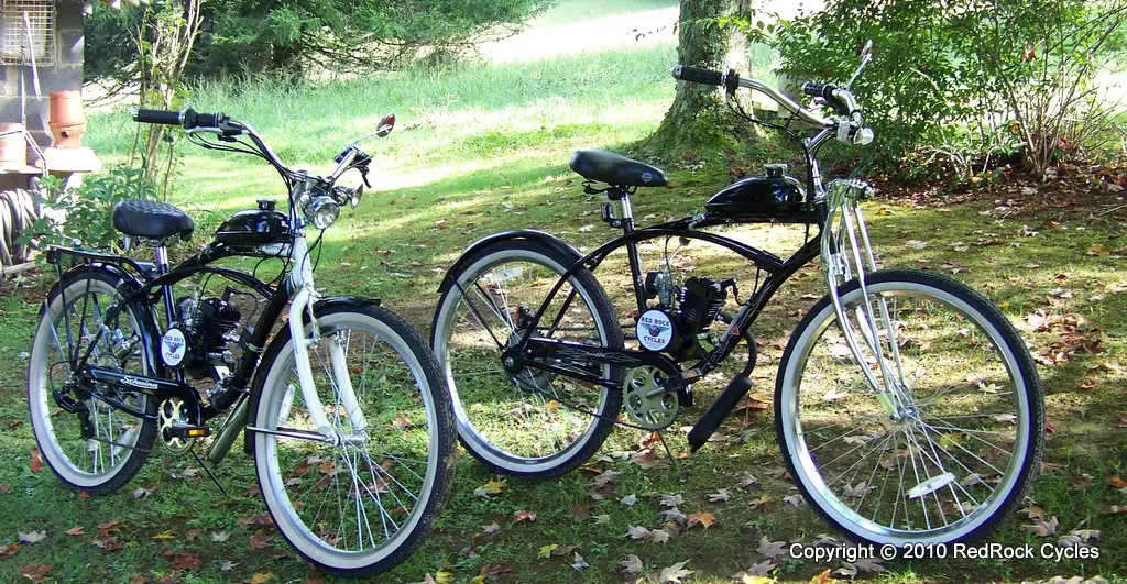

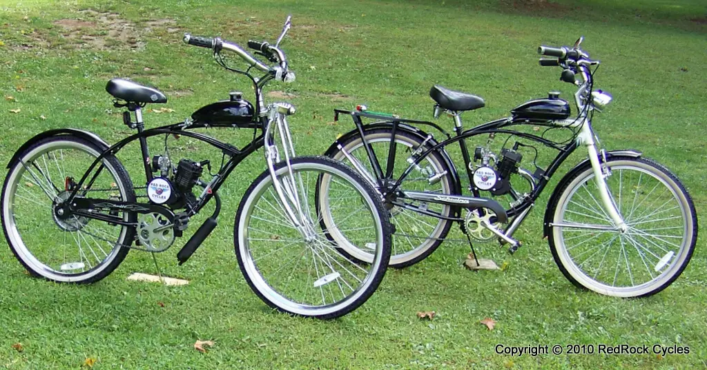

Here's one of my first Crannys with her big sister Schwinn Riverside(7-speed Delmar) Kruiser.This is a good comparison and as you can see the Schwinn is a much better platform,though the Cranny is lighter and a little faster not to mention cheaper($78 compared $119 for the Schwinn)...Take a look....Cheech
