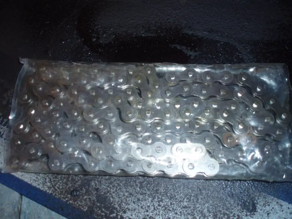

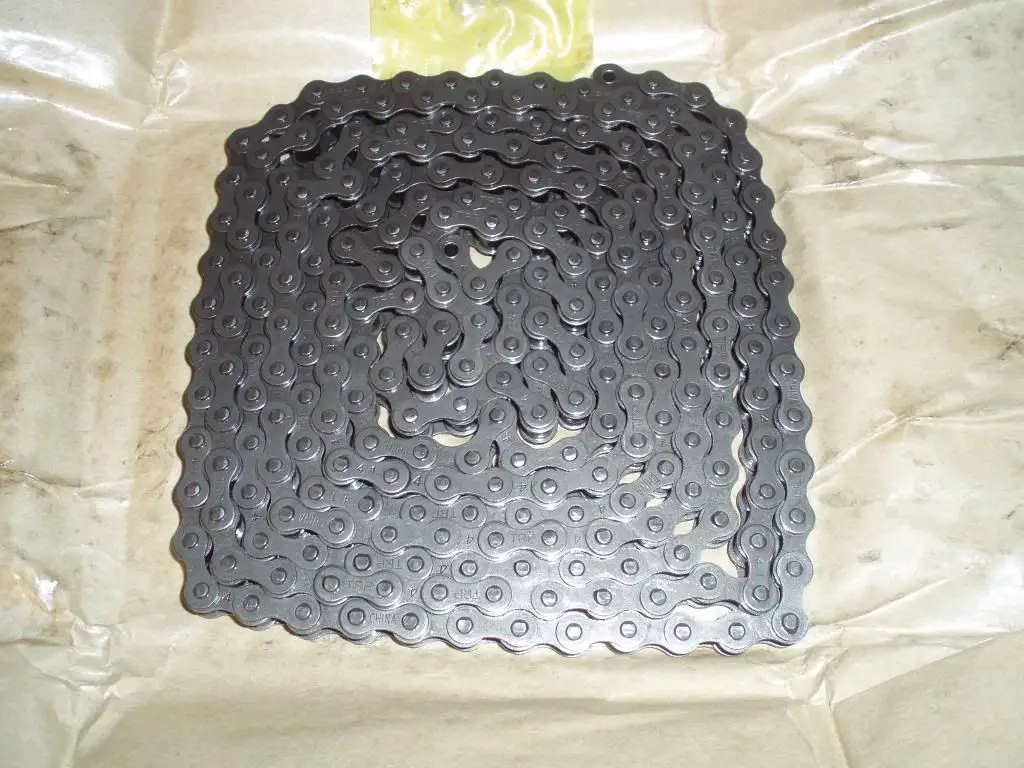

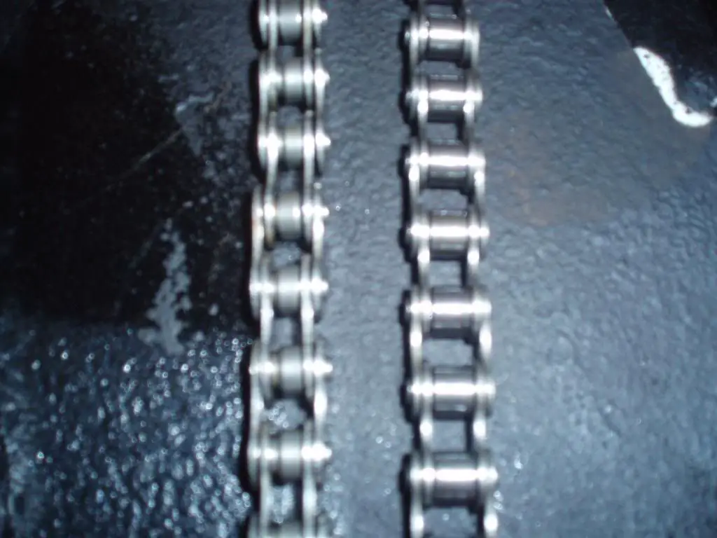

I think that the #41 is the way to go. It's a lot more durable, seems to ride on the sprocket smoother, fits better, and you get alot more chain for the money. In the pics below, you can see the diff. the one on the left is the 415 from dax and on the right is #41 from TSC.This is about how much chain you get from the kit (415) And this is how much chain you get at TSC for about the same price
