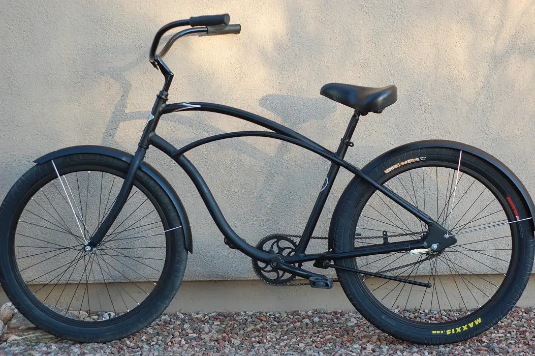

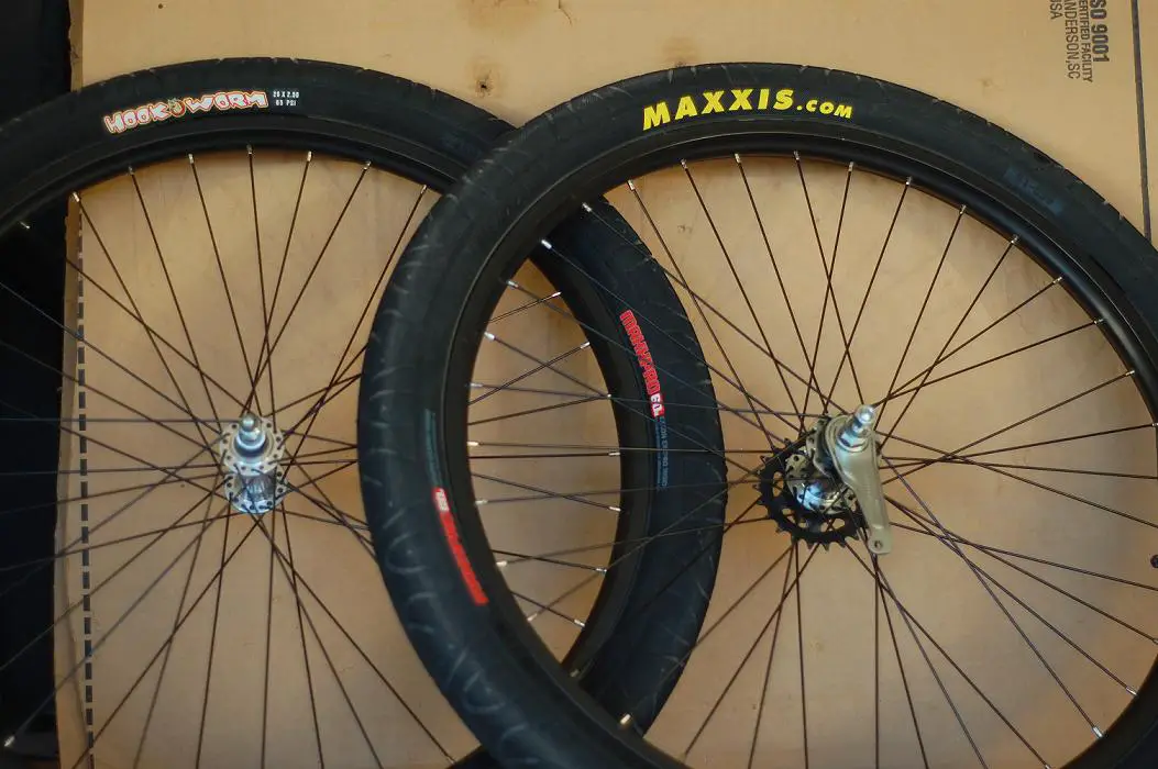

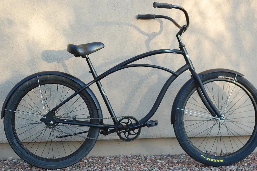

I just wanted to say thank you to Craigslist for having this beautiful bike and FloridaBoy for showing me how sweet this bike looks with a motor!
Im taking the motor that's on my Cranbrook(less than 1000 miles) and putting on this bike.
Electra Coaster:
Aluminum Frame, Shimano Coaster 36H, 14G Stainless Spokes, Alloy Rims and Maxxis 2.5" x 26" Hookworm Tires
Things to get:
Jims Motor Mount(ordered)/Sprocket Adapter
40t Sprocket
SBP Expansion Chamber/ STC Expansion Chamber (Witch ONE????)
12v Battery with Head/Tail Light
The 15" Apes from my Cranny
I will be SET after that!! Im starting after I get back from a 3 week trip. Im so Excited I had to show you all.

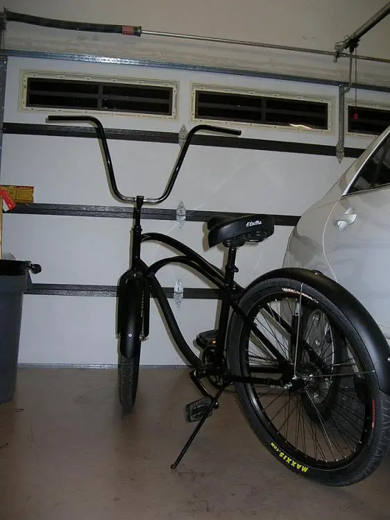

It rides like BUTTah!
Got the apes on

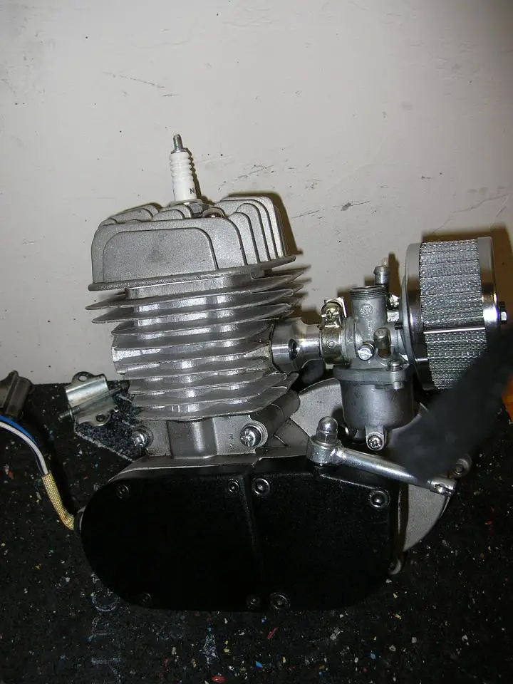

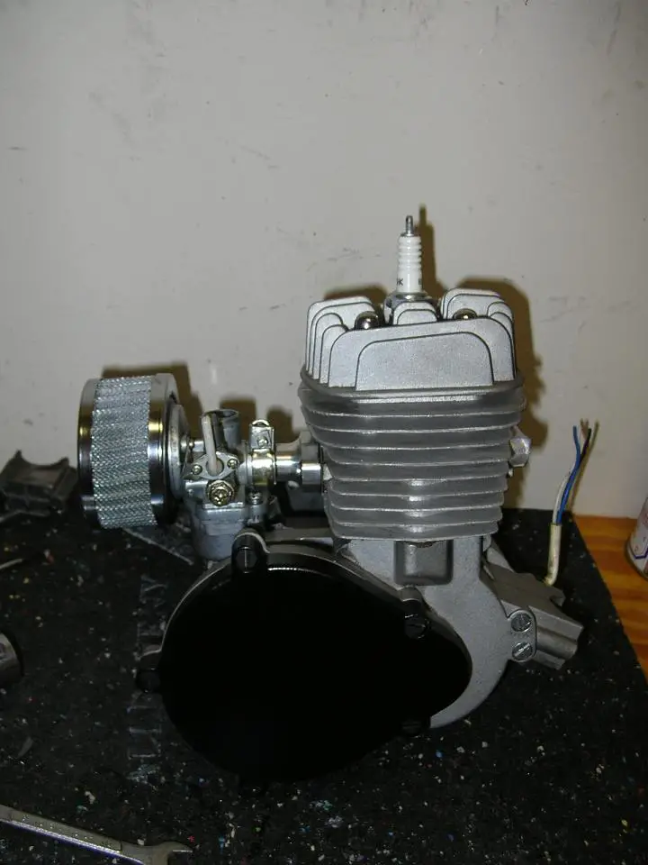

Painted both sides of my motor this evening but I ran out of paint. Im going to black out the cylinder head as well.
Man O man.....No MB'in for three weeks is gonna suck, leavin for Cali. Im hopin Jims mount will be waiting for me when I get back
Cuz I cant wait to get at her.

Thats goin to be one sick ride Tcams, good score on the bike, and i like to see that intake on that motor, dont forget to still use some RTV on that intake to carb mount, i dont know if the O'ring alone is enough to stop air leaks, if you did use the gasket maker already than thats a good clean job doing so!!!! Have fun and we will ride when you get back. My motors are coming today!!!! I cant wait to check em out

make sure you tell Jim about the rear departure, and about counter boring the rear sproket. you might want to mention to him floridaboy, and antihista' electras. also your 2.5 inch rear tire might be a problem, we are running 2.125" tires and had to bend to coaster arm just to get enough clearance for the chain

the rear departure is the coaster hub
here is a picture of my bike
http://motorbicycling.com/f15/electr...uild-8373.html
pic 3 shows the spocket counter bored, i have now changed my bike and removed the motor mount from jim because both mine and my dads broke and now we have a mount made of steel and rubber isolated mounted bolts
also i had to change the gas tank to a rear mounted one because i kept breaking the regular tanks
