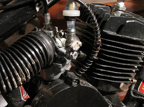

While having two shut-offs can be handy, I removed the valve components and made a "blank" cover for it with a piece of thickish gasket material (I think I stole the idea from bairdco...).
I did it because the passages in that petcock are tiny and rely on a small rubber bit with four holes in it... It didn't turn out to be the source of my problem after all, but I left it like this for a coupla reasons, one of which is I was too lazy to switch it back lol

i took the two little screws that hold the petcock together, removed the petcock and all the stuff inside (round washer that looks like a button, spring washer, whatever else...)
then i just made a diamond shape block-off plate out of some thin aluminum and a gasket and blocked it off.
Barely Awakes photo above should give you an idea....
