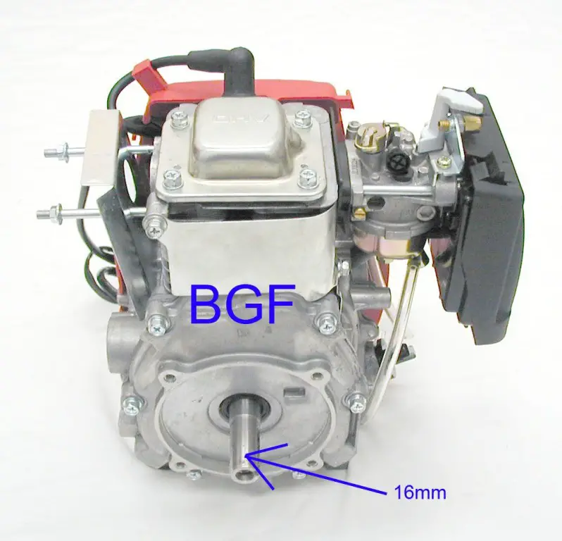

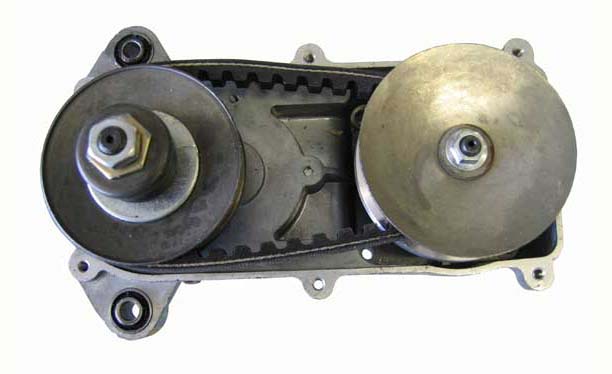

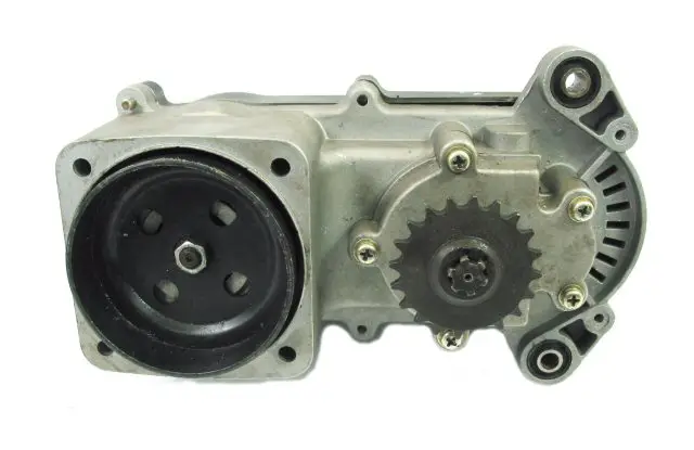

I was looking at the bolt pattern of the Hua sheng 4-stroke motors and it looks the same as a pit bikes, I was wondering if anyone ever hooked up a pit cvt or gear reduction to one of these four strokes?

ahh that looks sweat! exept the drive sprocket seems to be for smaller chain, not sure on the clutch bolt padern. i will have a look when i get home but i cant be positive by just eyeing it, how much is that gear box btw?

I can tell you that the bolt pattern is not the same. The pattern of the cvt is bigger than the engine. Also, the output sprocket turns the opposite direction from the engine. The clutch bell is too small for the standard clutch also. I played with this for about a month before throwing it in the corner for a while.
Old 11-09-2009, 06:21 PM
civlized's Avatar
civlized civlized is offline
Join Date: Apr 2009
Location: Alabama
Posts: 691
Default Re: 4-stroke + cvt?
Also, I forgot, the crank shaft has to be cut off about a half an inch or so to allow the cvt to slide up enough for the clutch to fit inside the bell.

Bolts right up to a Titan and the Titan comes with a clutch. Fancy scooter sells a 12 tooth 12mm sprocket 1/2 inch pitch for bike chain. You can get 11 tooth 14 tooth for 8mm chain.

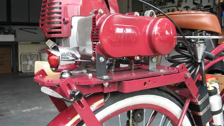

Neat times did a rack-mount. http://motorbicycling.com/f36/cvt-rack-mount-7265.html

the 5to 1 cvt and the 3to 1 you pictured will fit the right style motor you are talking about , but the one you pictured will not work, it has the wrong crank. its too long . you want the titan or one like it that has the shorter crank .

Well, not the HS engine, but 1400+ miles and reliable as all get out. Not a crotch rocket but it gets me around very well.
