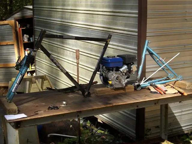

Well I have one of those 79cc HF Greyhound engines so I thought I would build a bicycle for it. I have acquired 2 of the inexpensive mountain bikes as donors. I intend to cut 1 behind the seat post and the other in front of the seat post amd join them together with tubing so I would have an easy place to mount the motor. Sort of a mid engine deal. This MB will be my winter project. I want to use a centrifigal clutch and gear it so it will hit 30 mph at 4000 rpm.

I plan to build it like this. Connect the two pieces with chromoly tubing and mount the engine with a centrifigal clutch. Get some bearing adapters made for the bottom bracket and use it for a jackshaft. Build a wheel with a freewheel on the left side. Anybody see anything wrong with this plan? Comments welcome.

Naw man - looks like she's gonna be a beast! Keep us updated on how this'un goes fersure!

cool idea with the two peices of frames

Lookin' forward to seeing her done Elmo. That's a perfect engine space.

Just thought about it, you have an empty BB. How cool is that! Could do so many things. Shifter or just reduction. Very cool.

Dan I have plans for a jackshaft there. Ron suggested making a shifter out of it. Do you think the Greyhound has too much power for a shifter setup? I am getting up in age but my mind is still young and I still like to hit the gas every now and then.
