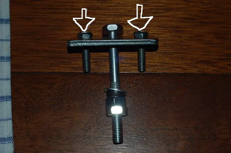

Im currently trying to figure out a way to mount the front part of the motor because the tubing is to big. Im going to buy a couple U-Bolts and a steel plate and work with that.
Should I use these bolts(in picture) to mount from the outside of the steel plate into the motor or cut the rods and just double nut on the outside of the plate?
Someone please give me a clear way to mount the front w/ a plate and u bolt..It would help me out SO much.
Thanks

I want to know weather I should use the bolts in my picture(or buy longer ones) OR cut the rods that come out of the motor and just double nut them on the other side of the plate.
Yes you can use the small bolts in your picture when you use a 1 1/2 half inch exaust(muffler)clamp with a peace of steel you drill holes in.....You can also take a pair of vise grips and take the long bolts that are in the motor out....Also so you know,they have a whole site on this forum for mounting advice and ideas....Mounting Techniques - Bicycle Motor at Motorized Bicycle Forum Check it out it has tons of great ideas....

I shoulda explained "proper bolts" a bit better heh, I had a similar issue as Tcams and the bolt heads protuding from the forward mount hit my frame before the plate did - so I got bolts with heads 1/2 as thick (still hadta bevel them slightly with my dremel) to allow it to seat properly.

It does not show well in the photo, but the steel adapter plate in the photo is modified. put it in a large vise and used a BFH and a block of wood to bend it lengthwise to match the angle of the down tube. along with the spacing provided by the puck, its another solution to the same problem. Joe
