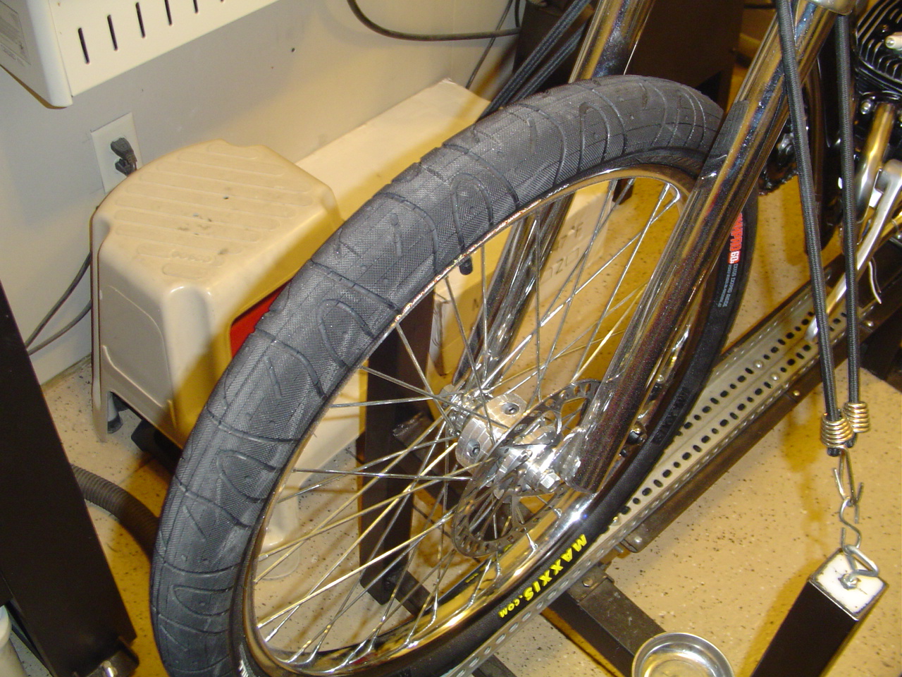

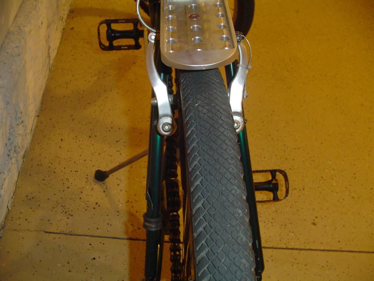

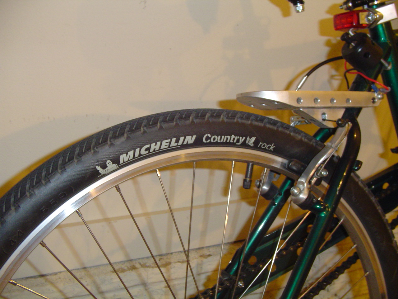

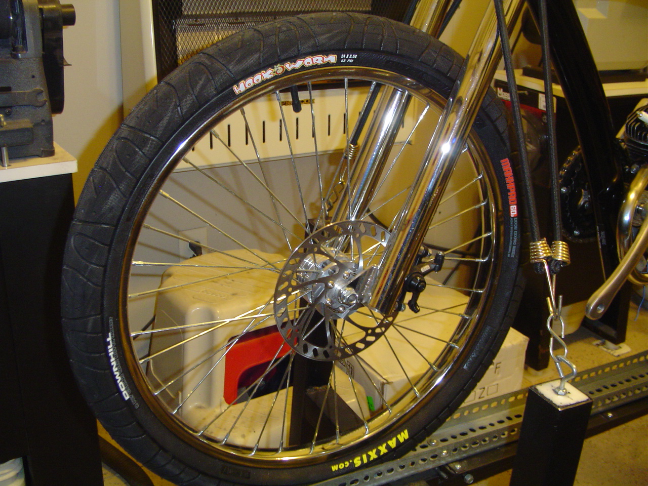

* I always put new tires and tubes on the bikes I buy on craigslist. Myself, I think that is thee most important thing on the bike as far as safety. My favorite tire for the money is the Michelin Country Rock. It is an all purpose tire made mainly for hard surface use. They run almost perfectly true, and are a very durable tire. You can usually find them for under $20 a piece,* Now if you want to spend a little more money I would definitly say the Maxxis Hookwork! They have tremendous traction and are almost bullitt proof. They will run you around $30 a piece for a 26 X 2.0.* John

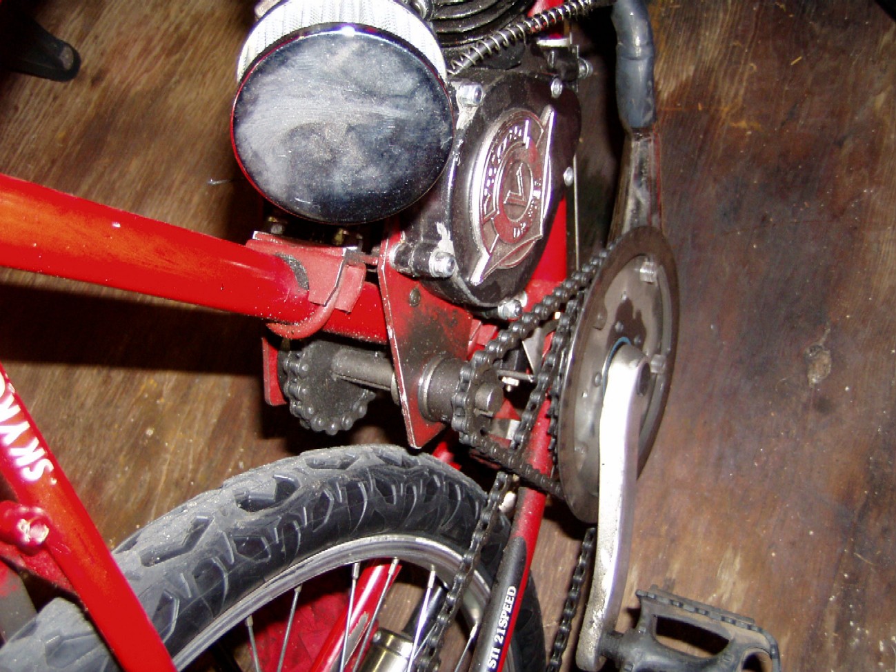

i'm runnin Kenda Kommuter tires, and they work great, low rolling resistance, good traction. dunno how they work in the rain, because it never rains here. the only thing is they're 26x2.0, and i want a wider tire. (first pic)
