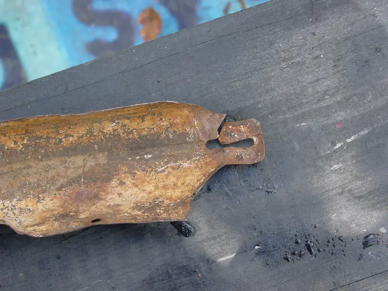

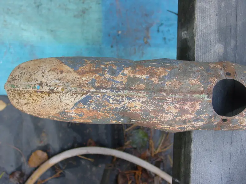

Pictured below are a couple of battered up gothic fenders from a 1940 Elgin, to be mounted on a 1939 Elgin. I know, they look pretty rough and are going to be a challenge. In both pictures you can see where the metal is fatigued and needs to be repaired. Especially considering they are going to be subjected to the rigors of a HT engine vibrations, I want to be sure they are sound. These fenders are heavy, with good metal in them, but they are old and have been abused. My question is in how to fix them. I don't weld and that kind of seems like overkill anyway. I am pretty good at soldering, with much experience joining copper pipe (ran a resort with lots of plumbing work) and soldering lead (had a stained glass shop at one time), but that is it. I did manage a couple of throttle cable modifications with silver solder, my only experience with silver. I was thinking to first clean up the fenders by stripping them, which has to be done anyway. The repair areas would be subjected to the wire wheel and thoroughly cleaned down to bare metal. I would use my propane torch at fairly low heat, silver solder flux the repair spots and apply silver solder, with just enough heat that it flows into the fender and is not just sitting there in a blob on top. Am I on the right track? Will this make a good repair or am I wasting my time? Is there a better way to do this? Is silver solder necessary or could I use a less expensive solder. I'm spending a lot of time and effort on this old bike and want to do this part of it right. While I want it to look good, I'm more concerned with it being sound and riding safely. I'd like to think this classy old bike is going to be around for a very long time. I now have the frame stripped to bare metal and am beginning on the fenders, fender skirts and chain guard. Thanks for any suggestions.

I would say only welding will safely repair that. You may try several layers of fiberglass or other structural cloth, but I am thinking it will need to be welded.

solder or in this case brazing, only works if the pieces over lap, that fix would be a butt joint and needs to be welded, plus to get them smoothed out and looking nice your going to need a planishing hammer and english wheel, would be a lot of work when you could probably find a used set or repops pretty cheap.

Thanks for the input. I think I'm going to try to use them anyway, I'll experiment with one fender. What about if I were to beef up those spots with a layer of steel fender scrap underneath and bolt or rivet the two layers together... solder from above and then use a dremel tool to make the openings the same... or take them to a welder. Those couple of spots shouldn't take much time, effort of money. I think those fenders would be hard to replace and I face the same task with the chain guard and fender skirts which can not be replaced with reproductions. Original parts in pristine condition are way beyond my budget. Poor in cash I am, but rich in time and determination. Since these parts will all be painted, I can also do some cosmetic fixing with epoxy. I have a whole winter ahead of me with lots of time to kill hobbying. I did some fairly successful fender work on some old Schwinn middleweights, removing dents with a rubber hammer sanded down to the shape of the inner fender. I would hold that in place with the fender resting on foam cushioned wood and then give it a whack with another rubber mallet.
As far as the metal repair it sounds like I should have it welded professionally. Thank you guys!

using body filler you coud just patch some tin in there with rivets and bondo it up. but welding them up and rolling them out till they looked like new again would be a ton of work.

Silverbear if you have a propane torch you have enough heat to silver braze or even brass braze some patches on the under side of the fatigued areas. I wouldn't soft solder the patches, might hold but it might not too...silver or brass braze would though I'm very sure. After patching from the under side use some soft lead plumbing solder on the top side to fill in any rough spots since soft solder is easy enough to sand smooth. Soft solder's low melting temp won't bother the brazing work on the under side either. A trick to make sure your braze flows well under the patches is to drill a few holes in them then dab your brazing rod in the holes as you go. Use lots of flux!!

You can massage the dents out with a ball peen hammer against a bag of sand, take your time and remember that a light hand is best. Get them close then use body filler to smooth them out.
As far as the cracks, you don't want to weld. I had a heck of a time with mine, even with my 110v wirefeed on the lowest setting I still was blowing holes.
Make some patches to go inside to bridge the cracks and either silver solder or even better brass braze the patches in but for brass you'll need a lot hotter of a torch.
For the mounting tab just make a matching piece, have it go about an inch beyond the crack and braze it on the inside of the fender.

Thanks for the great ideas which are also within my reach. I was thinking to use the front end of another rear fender to get a matching tab for a patch. I'll use the mangled fender from the 1940 Schwinn for tab and patches as it is good metal. The advice also matches up with my budget, too. Perfect. And thanks for the tip on addressing the dents on the the fenders which will also apply to the chain guard and skirts. I never did have aspirations for a 'restoration' so that I could have a perfect piece of memorabilia to sit around and look at. This is going to be a motorbicycle to use, a rider which I hope suggests another time when things were simpler, slower and made to last. I want to fit a pull start automatic HT on it as a kind of comfort step through cruiser for elders. For somebody like me, for example. Or I'll do as originally planned and sell it to a geezer with money. Under the yellow paint was a kind of beige with dark brown trim. If I went with those colors I'd redo the seat in brown elk hide and do a covered behind the seat gas tank and grips in matching leather. I think that would be a nice look. It's fun while all is dents and rust and missing pieces to project into the future and see it as it will be. While I was stripping the frame I was wondering who it was bought for back in 1939. Being a guy, I of course wondered if she was good looking, a pretty young woman with long hair, a teenager, probably. Was it Christmas? A birthday? It made somebody happy and will again in it's new and more robust incarnation. Old bikes are time machines of a sort, don't you think? Thanks again.
