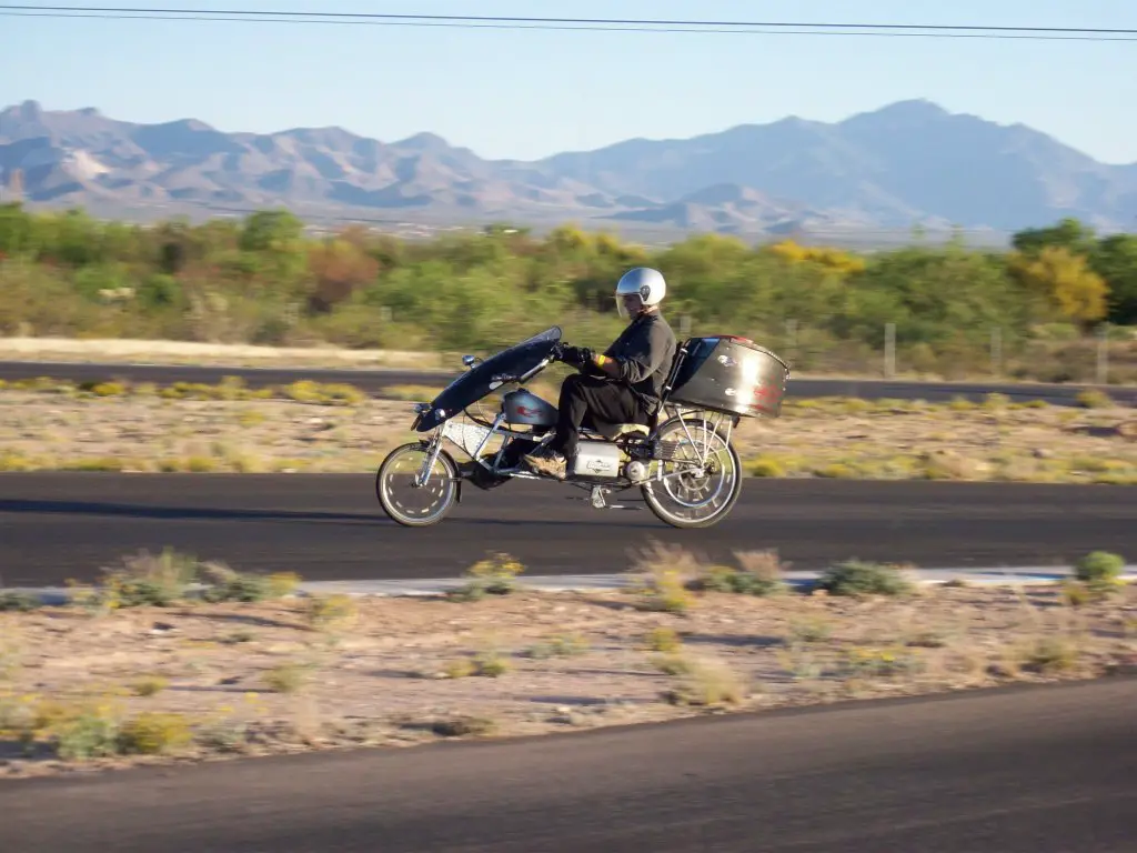

sfeland Is using this on his recumbent
"I did have to machine a part to be able to fit the variator on the Harbor Freight motor shaft), and the centrifugal clutch with the spring loaded pulley is used on a 150cc scooter. The shaft is a 5/8" shaft so a Comet Torque converter should work. The 1st drive belt I use is for a 250cc scooter. That should help keep the maintenance down a bit! The final drive was a GEBE system but the bike and I am too heavy and the motor is too strong for the lightweight belt as it lasted about 200 - 250 miles even being very careful. The final drive I use now is the Whizzer drive wheel with a machined V-belt pulley on the Jack shaft. Today commuting home from work coming down a slight hill with some help I was able to get the bike to hit 37.2 mph. Cruising speed is 30 - 32 mph. Someone asked what my gear ratios are... They are GOOD! Seriously....... I will check that out when I have a bit more time and let you all know. I do have a GREAT power band for a heavy bike and I am not lacking power at the top end at all. I do live in Chandler and normally have Monday's and Tuesday's off so if someone would like to check the bike out a bit better, just let me know. So far I have about 1400 miles on the bike, about 80 with the new motor and the rest with the good motor I just took off. So far.... knock on wood, I have had absolutely no trouble with the current setup. It is an ideal setup for commuting.... IMO. Best wishes, watch out for the crazies and stay safe on the road!"
sfeland

Ok I gotta ask, is that a washtub on the back????
