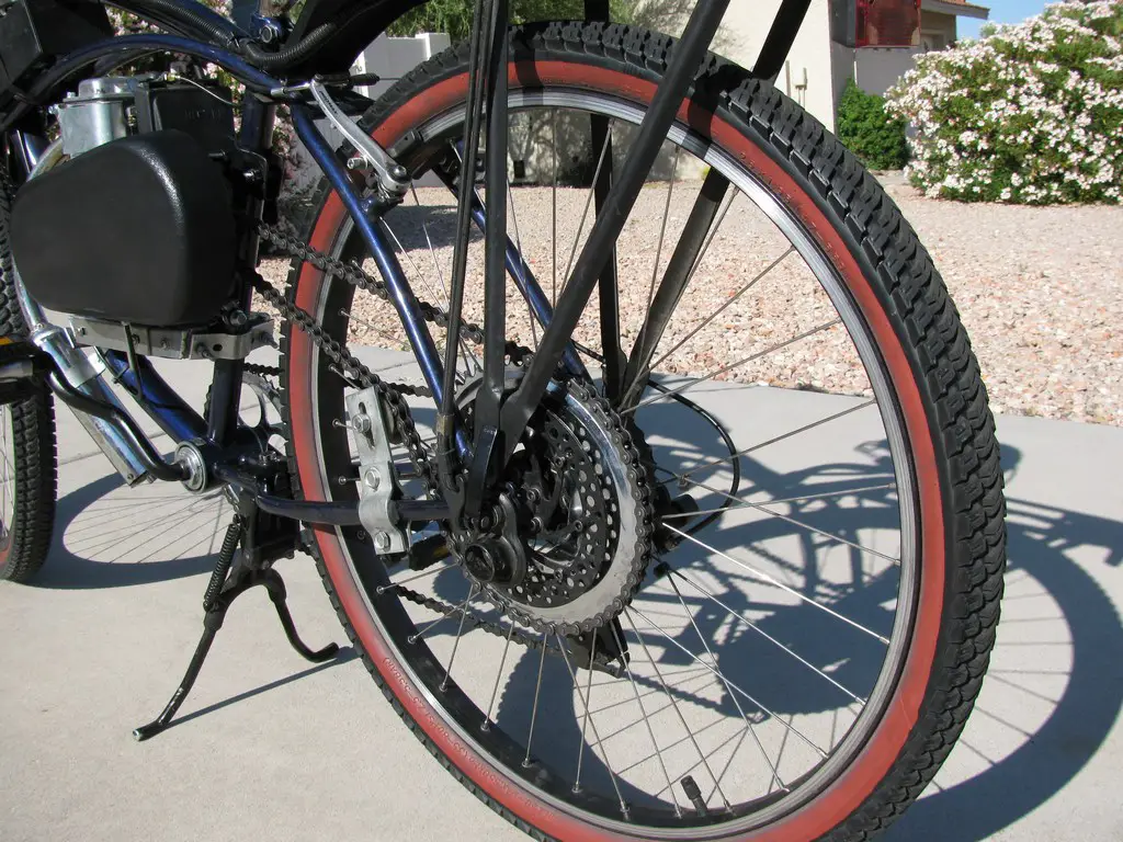

as stated by 2-door,,they have been mounted to disc brake capable wheels
I have over 8000 miles on this wheel, it has been trued once !!!...thanks lennyharp
Name:	mini-May 15 '09 chrome 50 tooth.jpg
