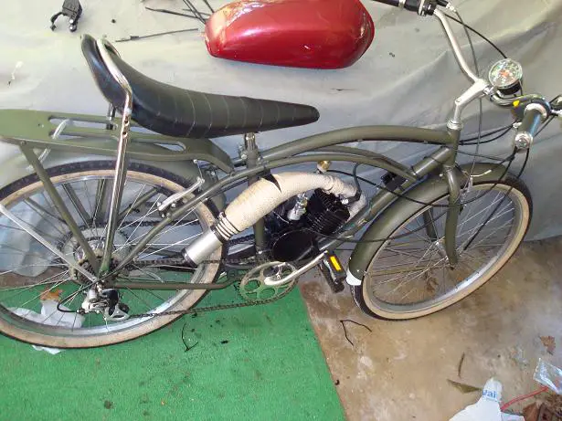

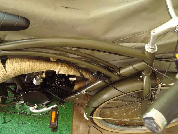

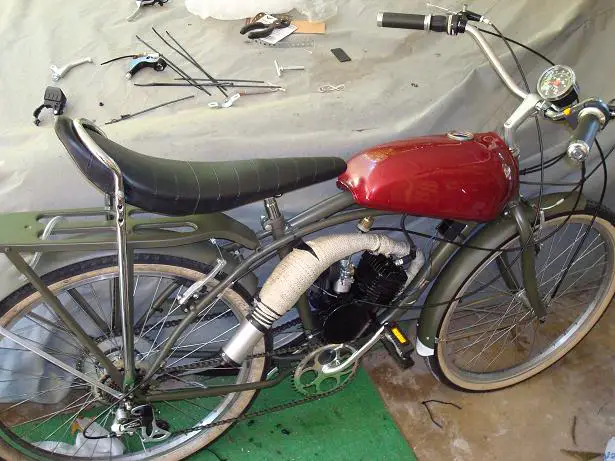

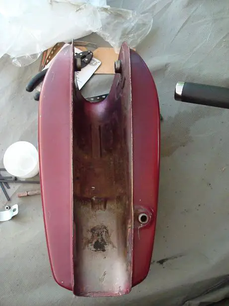

I just bought an old motorcycle gas tank (freshly lined)
I was wondering if anyone had any experience mounting one to a Motor Bicycle

I have mounted a 3.3 gal tank on a chopper (nirve deviate)
gallery384
most mount differently (frame specific),,,a pic would help us help you

Just as an update,
I have tried many forms of manual mounting (clamps and such) all to no avail
I tried JB weld which just snapped right off (actually very surprised. bare metal and everything)
I even tried a form of synthetic clay
So far nothing has been able to hold up to the vibration

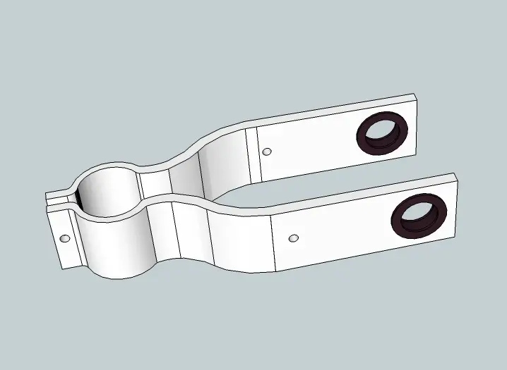

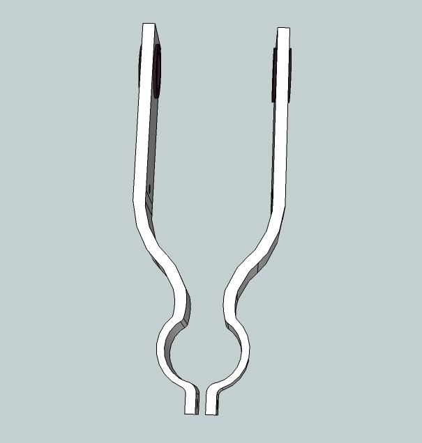

Get some foam pipe insulation to go around the top tube of your frame. I'd make a frame clamp that uses the pins already in the tunnel. Take a couple of pieces of flat bar, find some grommets that just fit over the pegs on the tank, drill the flat bar to fit the grommets, bend the flat bar into kind of a goblet with a ball stem shape so the ball section clamps around your frame and the goblet section has the grommets for your tank pegs.
Nothing to scale but here's a quick model I made
