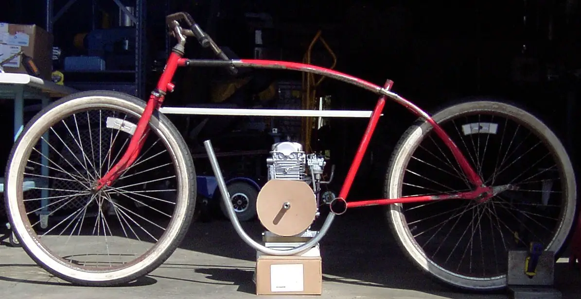

Hey Guys,

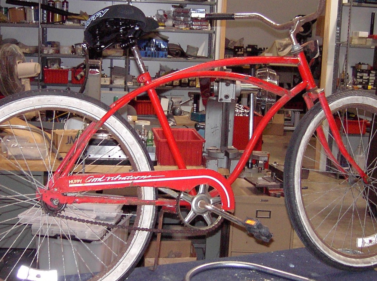

I'm new to the site and have been very impressed with the Boardtrack versions posted that I started one myself.
I had an old Huffy frame, that was made in USA, and bought a GC160 Honda engine. Decided to stretch the frame 6 inches and add a loop like a few other have done. I stripped the shroud and tank off the engine and will make a custom tank and maybe some side plates for the engine.

I'll post pictures of the progress.
Mike

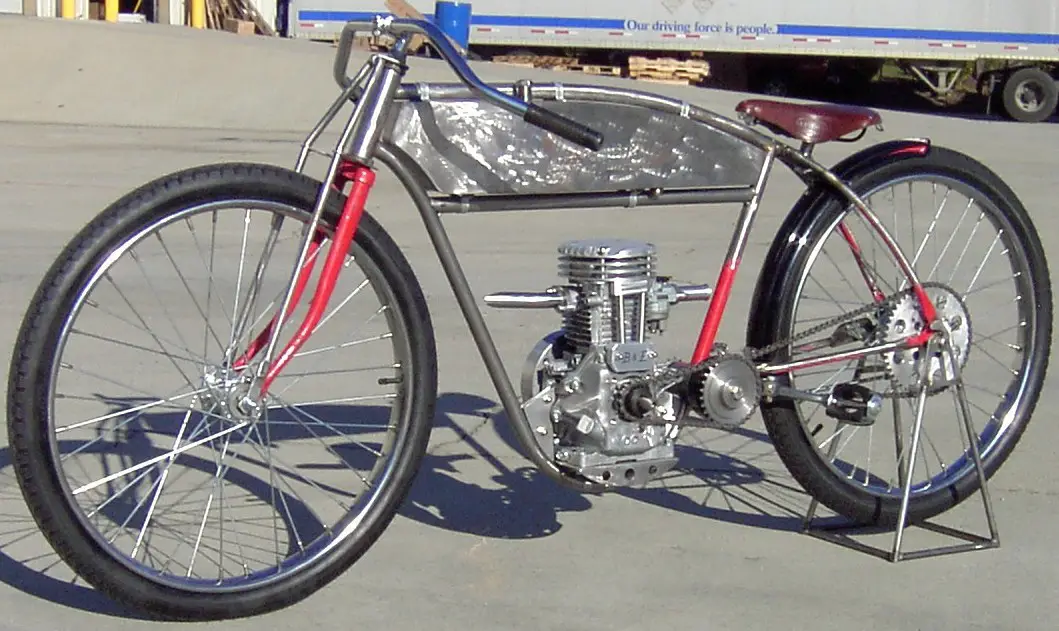

Added pictures of current state of build, 1/15/2010. Look at the following pages for more detail.

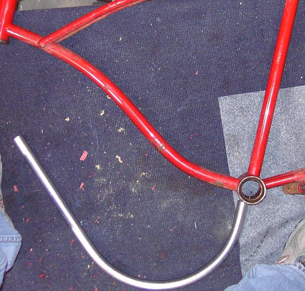

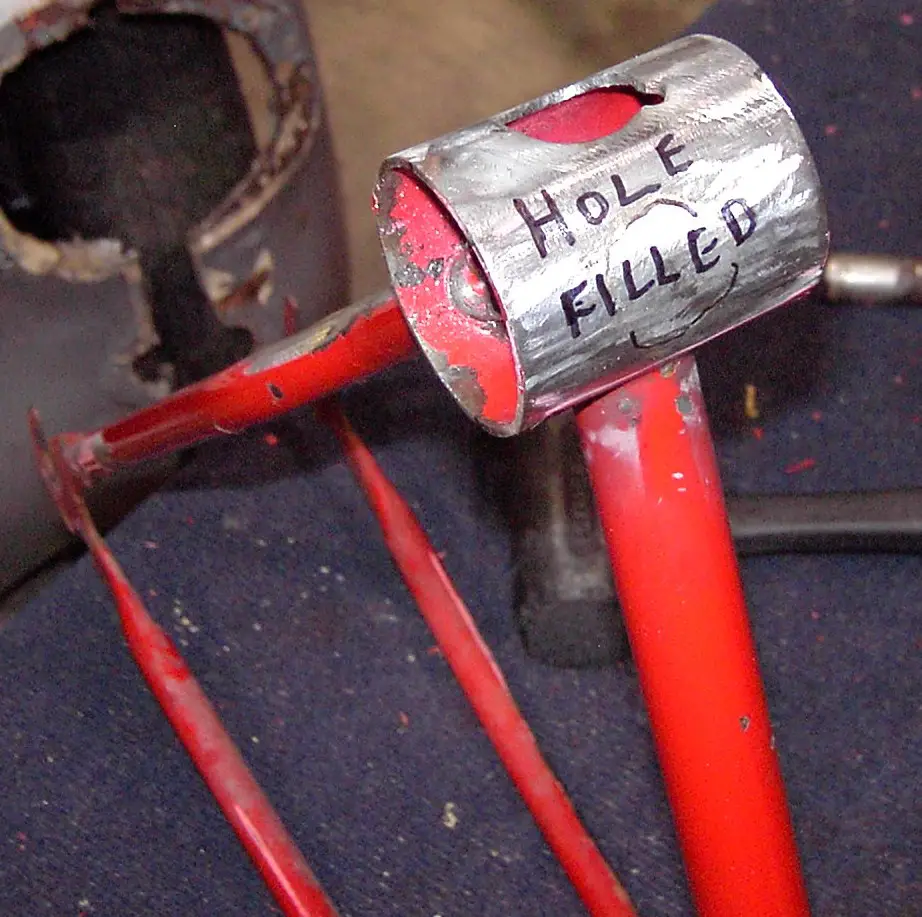

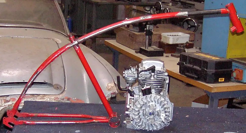

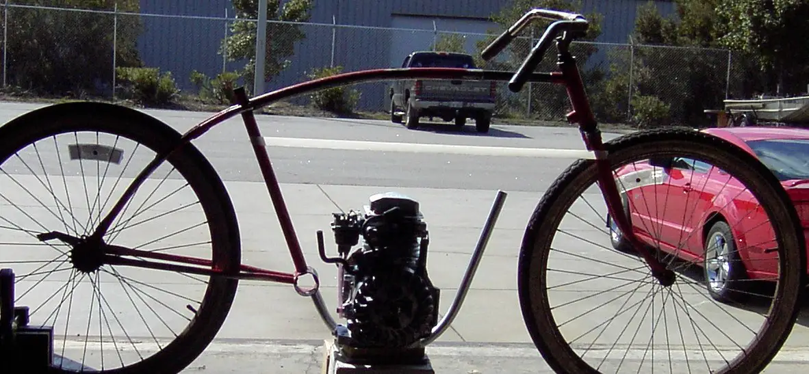

Here is a few pictures updating the progress made on the project.
Trying to get the look right, I think the engine drive needs to be centered with the hub of the bike.
Looks like the angles are close on the drop tube and loop.
Gonna be tough to fabricate a tank to get the space above the engine to look right.

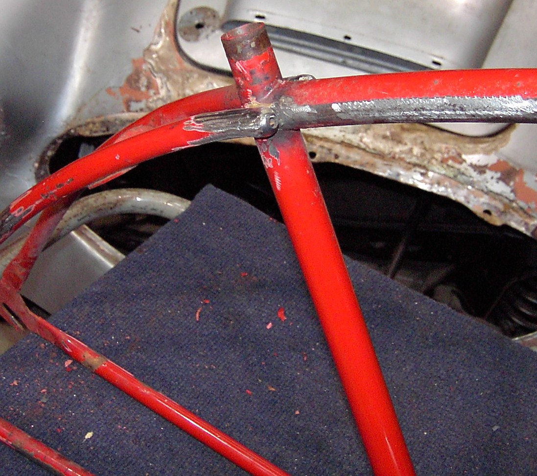

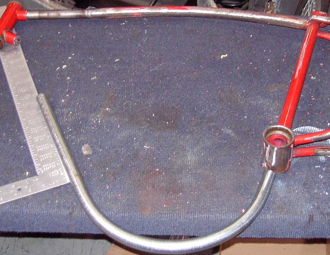

Added a hole to the bottom of the hub so the loop tube can look like it extends down from the seat tube. Also closed the ends of the rear wheel top tubes.
Start fabricating the tubing next, I'll post a picture of our homemade tubing bender.
Mike

I agree the frame lines are perfect! What is your wheelbase?
Old 09-14-2009, 07:19 AM
vrgt2003 vrgt2003 is offline
Join Date: Sep 2009
Location: Raleigh NC
Posts: 96
Default Re: Board Track Project /Honda Engine Update
The wheel base is 51". We stretched the frame 6".
Mike
