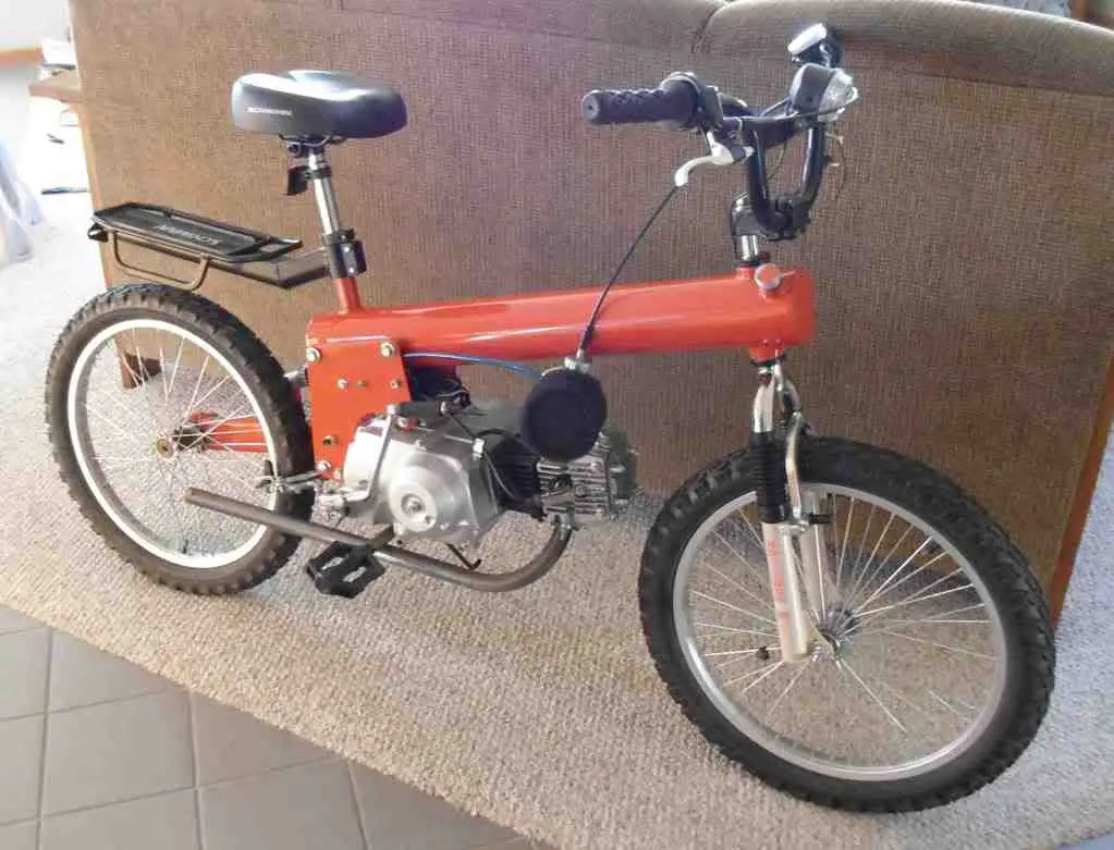

this is what ive been working on

Wow,
It is so different I love it. Do you photos of the build as you were putting things together? What is the engine? Did you fabricate the frame and gas tank or is that ready made? How's it ride?

That's a sweet looking ride. Are the pedals useful or just for resting the feet? It looks fast, whats the max speed?
Thanks for sharing, Kevin

Frame is by me. Tank is the frame. The bike parts are from a donor bicycle. Pedals are pegs now. Engine is a Honda copy/replacement. Basically a four stroke pit bike motor. Top speed- bout 30 with a 50cc.... I have a 70cc Z Honda clone that does 50+ and another with a 130 thats good for 60+. A 90 should do about 55+.

That thing is, Awesome, Sick, Weird, Retarded, Sweet, Crazy, Mad, Great, Ridiculous, and Brilliant all in one. Is the tank an old hydraulic cylinder?
