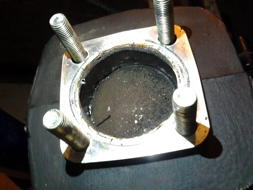

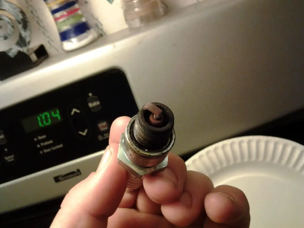

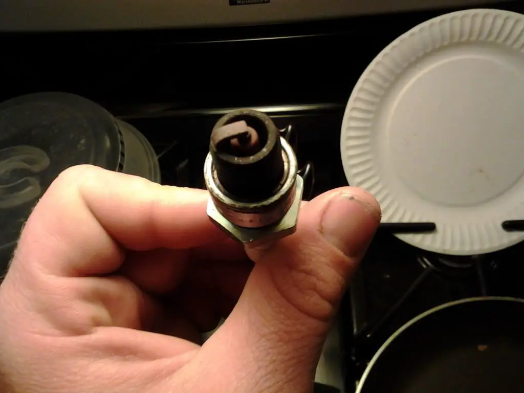

Well I can say that my plug is not grey. My plug is a rust color wat does that mean? pic included. When i switched to opti i had big time 4stroking then went down a jet size to 68 still 4stroked but not as bad then went to 66 and perfect never ran better till it seized 2 days ago.
I think it was the pin that hold the piston rings cause it is on the top of the piston(pic on bottom notice hole in the head gasket where pin hit any help here but dnt wanna get off topic) Just would like to kno about the rust color of the plug tho I will try to reasearch the other. Thanks any input would be nice.

With a seized engine, spark plug color is the least of your worries at this point.
This may be a wild guess but I'd say that your plug is rust colored not because of the opti-2, but because your cylinder is seized and needs to be overhauled or replaced before you'd be able to get an accurate plug reading - whether you're running opti-2 or any other 2-cycle oil. You have to have normal compression in a healthy combustion environment first in order to be able to accurately gauge spark plug color. Low compression in a damaged engine would give your plug a rusty, dark color regardless of whether or not you had the right jet size, carb adjustment or correct oil with proper fuel/oil ratio. You'd have to overhaul or replace the engine first before you'd be able to start reading plug color once again with Opti-2.

no it dnt run any more it seized up on me, my gonna tak it apart to find out why and rebuild. before it went it had great compression could hear the vacum. it ran really strong 32 wot and it was a 48cc. i never got that grey color before it did go. it was my first bike got it used they said it only had 100 mi but the piston had all that carbon on it wen i got it. since then i tuned it ran way better and put 600mi since i have had it. once i rebuild i will do a plug chop
