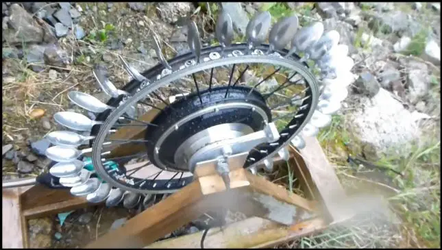

...was putterin' around the interwebs, wandered into this & while it's just an experiment, I jus' hadta share this guy's creativity - he's cobbed himself a genny for less then what jus' a Pelton Wheel costs (ebay), with regen it's got some potential lol;
ryanonthevedder said:
Used a 500W hub motor and some spoons to make a pelton turbine hydro generator. This is the working generator running off of a garden hose.
The plan is to take it up to the gold claim and use it to power the cabin and charge the batteries that I use
http://youtu.be/spAxoOrC4PA
...I love the spoons :D

It's an interesting concept for sure, although a bit atypical for a Pelton Wheel using the hub like that & I'd imagine he'll get far better rotation speed once he's made & aligned pressure nozzles... but yea, Peltons are perfect for LVHP sources (low volume, high pressure) like little creeks on farmsteads ;)

Wouldn't a lot of water drip down into the hub over and do damage over time?

Well... as for the water thing, I've ridden my ebike/hub motor in all seasons/all conditions for goin' on three years now & never had any water intrusion issues, in fact my very first test ride was in the pouring rain, not that I was psyched for that sort of test but it did jus' fine so the above should be good *shrug*
It isn't an optimum setup for a Pelton wheel it's true, nor is it particularly economic if you haven't a spare hub or cheap used ebike... but it is an awesome example of tinkerin' around & experimenting I figure ;)
