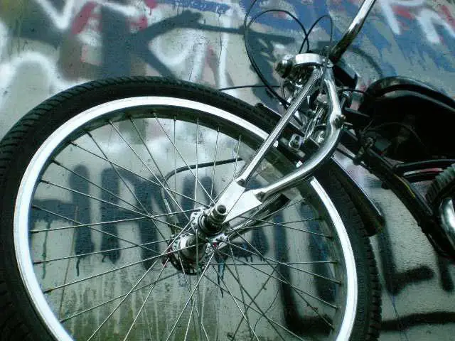

i think the tires should be fine if you put nobby tires on its make the ride unplesant once on the paved road. you will need a brake handle right side cuz your clutch will be on the left. a cable and a front caliper , my bike shop usually has them on the brake post ready to instal . in a bag waiting for you to grab off the shelf . simply slid brake post thru hole in front fork (if caliper type very common) tighten down nuts on back side and move brake pads where the line up with the rim and adjust cable length so that the pads almost touch the rim but dont. that way when you start to pull leaver they make contact and if yousqueeze hard ,like say the instance arrises that you need a front brake like everyone here recomendes, its will be all stopping power.;) hope i didnt ramble to much
you can see the caliper on my bike in between the springer bars.
or if you want to spend a little money to ensure you safety you can find a front fork with a disc brake caliper usually meens a new front wheel as well . but all that money you save on gas has to go somewhere doesnt it.

Thank you, Oscar. Your directions and picture are very helpful. Another question has arisen. Can grease fittings be put in on a coaster hub? If so, would it just be a matter of drilling a hole and inserting the fitting?I am concerned about having to have to keep taking everything a part to regrease the bearings. I get the impression that it needs to be done pretty often. Thank you.
