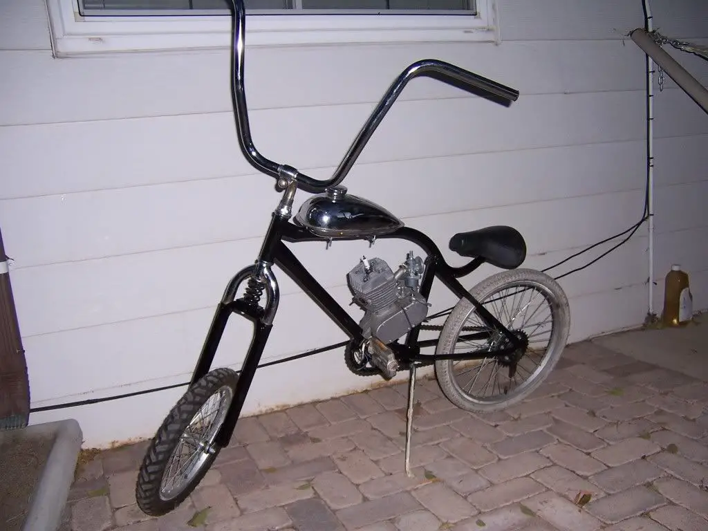

A friend left his kit at my house, because he was working on a build, so I used it to mock up this wee chop. I had been holding on to these forks since I found them because I had this build in my head.
20" rear 18" front 30 T sprocket (which I have found works well with a 20" wheel)

I just noticed I said 18" front, it is actually a 16". I may change it to an 18", because this thing has almost no trail and its a bit scary at speed.
Not sure exactly what you are asking about the size. If you mean that the front is smaller than the back, i dont think this alone afects handling. Changing the sizes will change the rake and trail though, and this should be considered.
As for the gearing, circumference is proportional to diameter so it is easy to get a conversion factor.
ie
26/20=1.3 so
a 20" wheel with a 30 tooth sprocket will ride like a 26" with a 30x1.3=39 tooth sprocket
or
a 20" with a 36 tooth will ride like a 26" with a 36x1.3=46.8 tooth (I dont think a chain would like a 46.8 tooth sprocket but you get the idea)
I disected a mountain bike front sprocket to make my 30 tooth. At that time I did some gps speed testing, but I do not remember the #s. What I do remember is that I chickened out before the motor rapped out with the 30 tooth on a 27" road bike wheel.
Good luck and Happy Trails
Kenny
