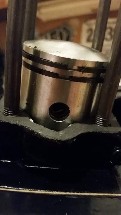

Decided to take a look before installing.

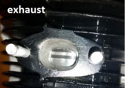

Here are my intake and exhaust ports, they look okay to me. What do y'all think?

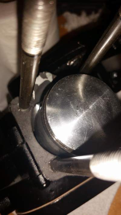

I read somewhere on this forum that I should sand down this part of my engine (not sure what it's called, a bowl?)
I chipped off some of this very brittle gasket, I'm afraid some might have gone inside :/. I also though tmy piston rings were broken when I realized they're supposed to look like that haha

the sanding of the "bowl" is called Lapping. and yes, do it. lap the head and the jug, so you have 2 good flat surfaces to join together via the head gasket. there is ideos on youtube how to do the process.
the jug gasket inside shouldnt be a big problem.. but try to get it out. and i hope u have a second one. because you need a gasket there!

Make sure the cylinder to case gasket is good before reassembling.
Use caution when putting the cylinder back on. Unless you have experience its easy to break the piston rings. They have to be compressed to slide back in the cylinder. DON"T USE FORCE or hammer on it. If the rings go back in right the cylinder should slide right on. The ring gaps must align with pins set into the ring grooves in the piston when compressing them.

Use care when 'lapping' the cylinder head. It MUST be flat. Follow the instructions regarding 'lapping'. It's easy to sand an angle into the gasket surface. That you don't want. There is discussion on 'lapping' here. Use the search feature, key word, 'lapping'.
I never advocate a new builder begin by making modifications to the engine. Get some experience before worrying about hot rodding the thing. Unless you know exactly what you're doing you could ruin a brand new engine by grinding on things.
That will get you started. Good luck.

As for the intake and exhaust gaskets; I like a thicker gasket on the exhaust, 1/8" or so. You can go thinner on the intake, 1/16" or even 3/32" is good.
