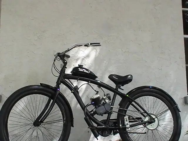

I built cruzer for friend! 48 spoke bike.
hwybikedon
Mar 25, 2012
61
Florida

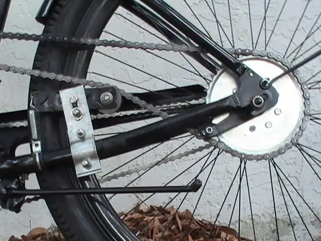

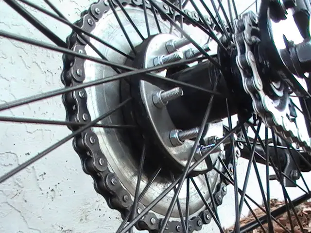

Had no trouble installing the stock 41 tooth .
He will be hauling a surf board on this beast up and down east coast of Florida,.

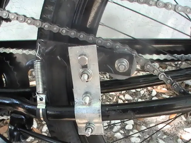

He said where is my spring, Changed the adjuster around for him.
Had to extend the tank bolts for the large frame just a tad.
Had to cange the stock black handlebars to big for the kit install.
It rides very nice for being a hard tail. All and all easy install!!

Nice mod to the tensioner.
rc
Presheate it rusty, you see it was off the stock set up. Bolt in the middle servs for two things, pivit point and will not allow the adjuster to get so loose that the chain will come off. Hope he picks this bike up soon, I have run three tanks of gas through this BGF motor so far. I think it's ready!!
