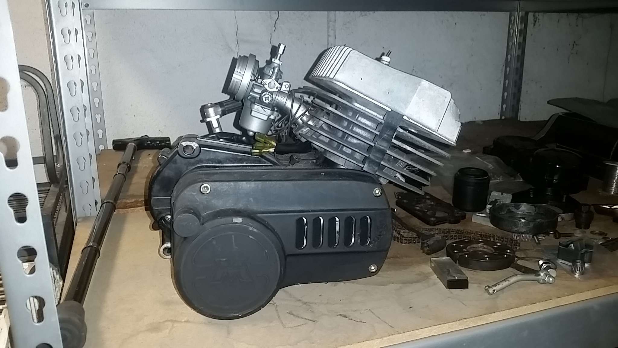

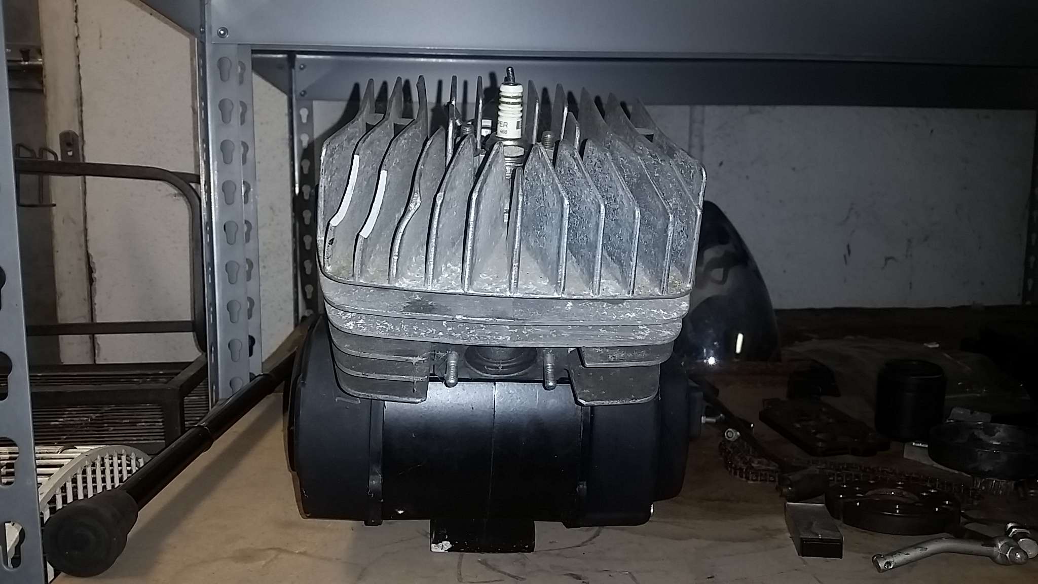

Here's mine in "as purchased" condition... It does have a few broken fins, but not bad enough to worry about overheating... This one puts out 3.9 hp stock so it's not a screamer but with the cvt and being set up for low rpm power these engines do well in heavier builds where top speed is less important than good bottom end torque.
I've been thinking about putting this in a Schwinn Stingray or a utility trike to make look like an old Servicar, but I'm open to all suggestions, this one won't be a daily rider but more of a show bike or trike...

If it has a tiny carby on it like the S6T model? The only difference I ever saw for the most part was better reeds and a bigger carby make a S6S model at 10 plus HP from a S6T!
I have not got to get up close and personal with the OP's motor or Daves. It is a nice thunk tho aye?
Does look like a small intake on that motor? I wager I could get a few Phonies out that model. Nice score!

Stock carb for this is a dellorto Sha 14.14 so there's definitely room for bigger, the carb in the picture is actually a nt speed carb just to keep stuff from getting inside the engine while its waiting for a bike....
I think the upgrade manifold for it at treat land is for a 21mm and they also have a big bore kit for it to bring it up to 70cc so bigger carb, better reed valve, and the big bore kit could easily bring it closer to the 7 to 8hp range... of course if the big bore was added a 24mm might be a better carb choice along with some mild porting this thing could perform. I'd definitely buy up some spare belts for the cvt to keep on hand if I do upgrade it.

I got a 21mm carby on a 50cc Morini and it is specked over ten horse power. I would say 12 hp at sea level perhaps. How you figuring for 7 to 8 HP? In better words I think it might be able to do more?
You let that thing breath better its gonna rev up high I am sure of it! With a fair prowless low end too.
Is the stock jug and all still in good shape?
That big bore kit is gonna put you at around 20 hp me thinks.
Edit just reread your earlier post you know what’s up!!.
