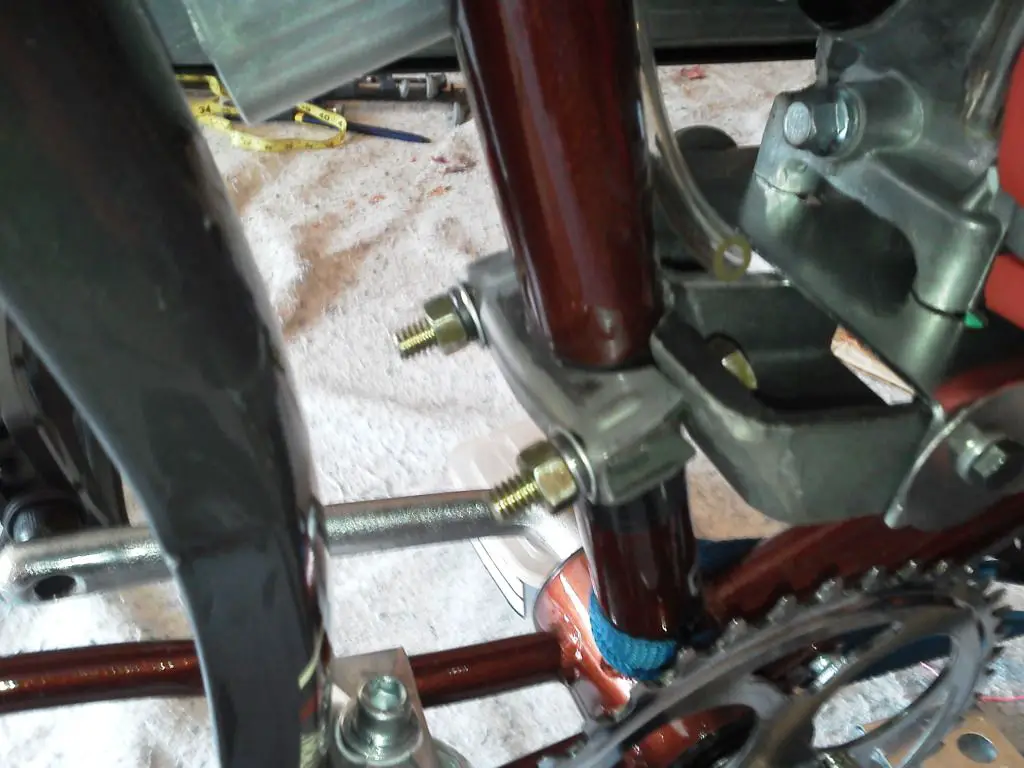

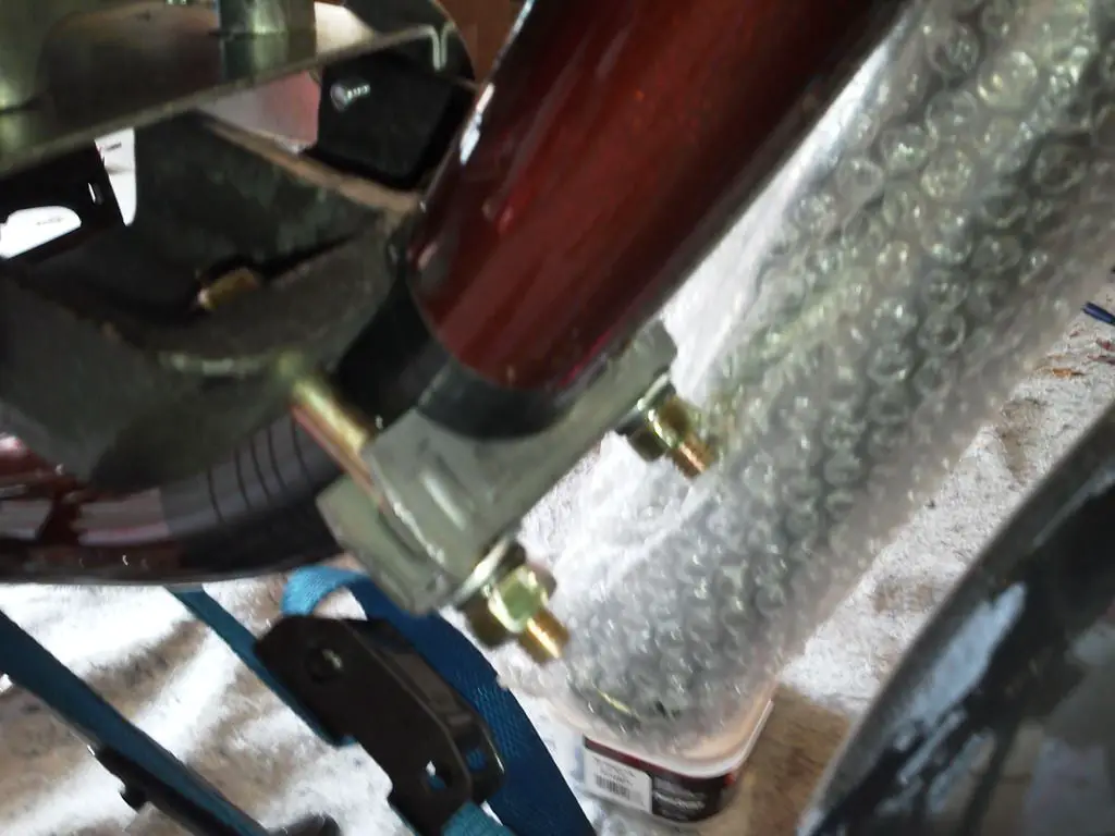

I had a problem with the engine mount not wanting to cooperate at first but have since persuaded it to do so. I took a small (dremel) grinder wheel and took some material off the mounting blocks to change the angle off the seat post/down tube. after getting the angles close enough I ran into another snag on the front mounting block. The holes for the bolts were not in line. 1 was 1/4 inch lower than the other causing the mount to tweak when tightened. Nothing a drill bit and some elbow grease couldn't handle though.
I also got rid of the flat stock that would be used to mount the blocks to the frame and used some brackets from 1.5" muffler clamps. these seem to work better as they conform to the frame better. I also upgraded to grade 8 bolts for the mount. other than the following issue (only took about 1 hour to correct) everything is off to a good start. I will post pics soon.

Front mounting block before altering the holes, you can see how they were staggered
These are the exhaust clamps I used, they are 1.5" diameter clamps and the bolt holes lined up perfect.

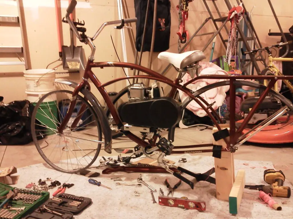

and the bike on my sweet custom bike stand. I have since strapped the front rim to the frame using a ratchet strap. and the black material is from an old nylon belt that no longer fits me.

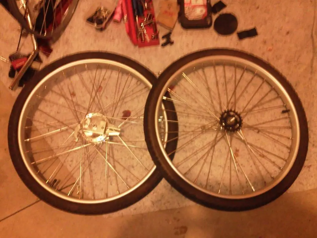

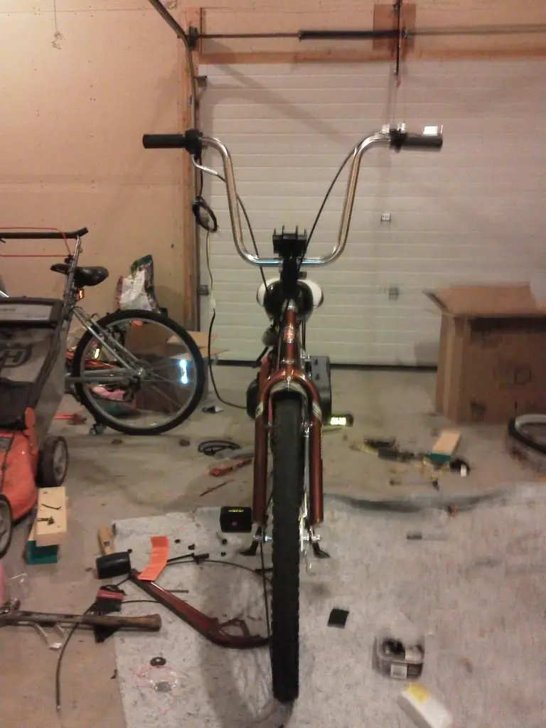

Well, today I got home to a pleasant surprise. My Worksman wheels arrived so I was able to get my bike off blocks. I have to say, these wheels are awesome. Super strong and it was really easy to get the rubber on them. The back wheel DOES come with the Shimano CB-E110 in case anybody was/is curious. I have to now figure out a way to make my front fender clear the exhaust. I may go SS flex pipe or something, I don't really like the look of the kit exhaust anyway. I also added the ape hangers and a RAM mount for my phone.

Just another in better lighting! Just a sprocket adapter w/ sprocket and non-kit chain tensioner is all that is needed now! Then I'll be riding! usflg

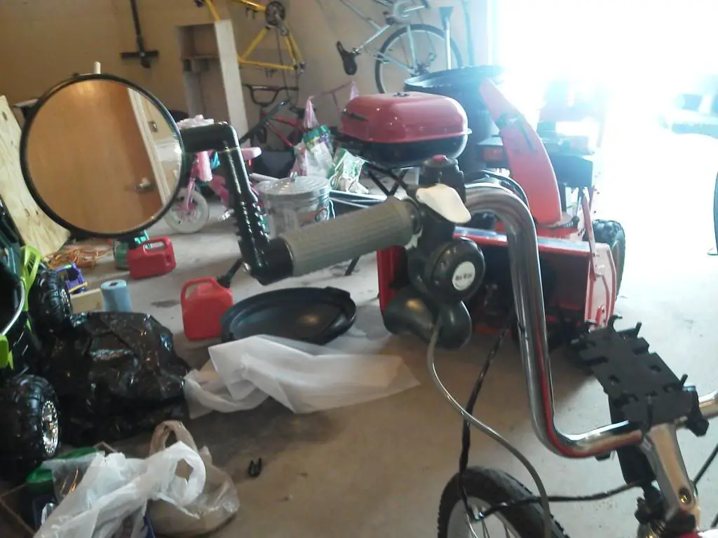

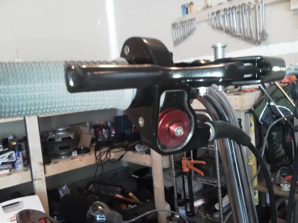

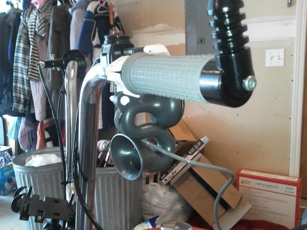

Update! With pics! I had some issues with the throttle in my kit so I got this one!
Got a mirror and Airzound horn! Don't mind the mess!
Close up of the horn!

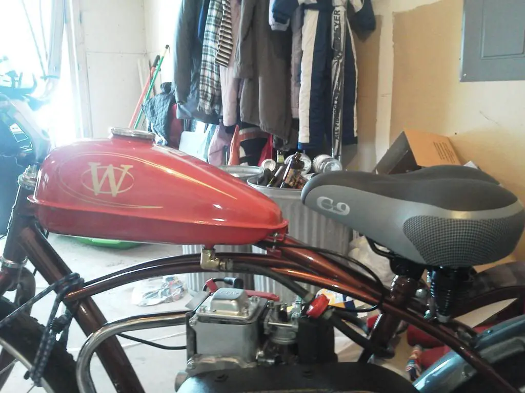

I didn't like the look of the peanut tank so I ordered this one from ebay and bought a cloud 9 seat for my bottom side! I will most likely repaint the tank. I am using slightly larger fuel line for a briggs engine and a briggs fuel filter and shut off.

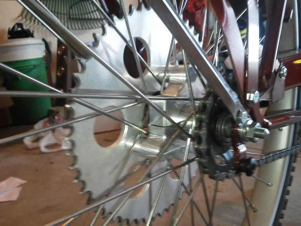

Also running a Pirate Cycles 56t sprocket and adapter.

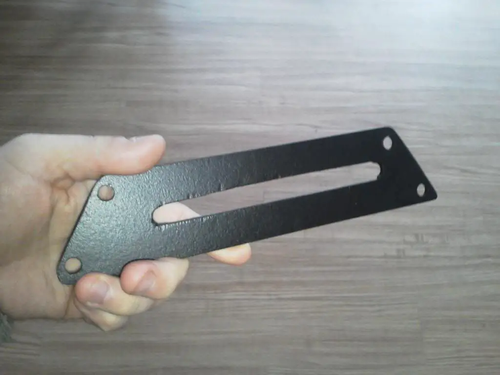

Chain isn't on because I just finished making my tensioner bracket. It's not perfect but for a piece of steel, a cordless drill, an angle grinder and some paint at least it wont get sucked into my spokes!

The bike ran good before winter. Using the 56t gear gives it a good top end and makes the acceleration a little slow of the line but I pedal with it to about 15 before I run out of pedal gearing. The throttle is a sickbikeparts.com and the mirror is from the local bike shop (ill get info when I get home). The horn is an airzound refillable air horn (look on Amazon) that turns 80psi into 115db. The tank is a whizzer reproduction from wildfire powersports that you can find on eBay for like 54+shipping.
