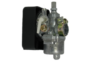

Just a quick thought...
There are two different stock carbs supplied with the "80cc" kits - the older style (but still common) and the newer one with the secondary fuel shut off on it (supplied with the newer Grubee for example). Tho very similar in outward appearance and many of the parts interchangeable, they're jetted drastically differently - the newer one's needle is significantly shorter as an example.
old style;
new style;
(air filter housings may vary)
This different jetting, while still not perfect is a heck of a LOT better than the old style one. While it would be nice to have the fuel/air mix adjustment screw on some of the aftermarket "racing" carbs, getting the jet and needle from the newer carb or just replacing your old one with the new "stock" carb is a step in the right direction at least.
This may also be some of the cause of the varying results people have had switching from stock to aftermarket...
note: while the needle & jet will interchange, the slide itself will not as it's a touch larger.

I have not see one of the "new" carbs arrive on a engine yet but did buy one and it didn't perform any better. The only advantage is that shutoff which allows you to remove the bowl w/o losing a filters worth of gas.
The dozens of "old" style I've had are all over the place as far as jet size and performance.
PS Can you see the difference in those needles with the naked eye?

xlite - yes, there's 1/8th difference (or more) in just needle length, I believe the taper was more acute as the top and point seemed the same size as the old one... but I had no calipers at the time, just put them next to each other and eyeballed - slapped it together and left for work lol
The performance gain could well be environmental, it's getting colder quick up here. *shrug* My bike is really happy w/it tho :)
