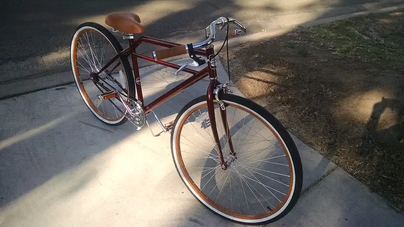

That's right. A Huffy. (I'm already starting to regret that purchase)
Stock photo, since I didn't take a picture:
It was this or some cruiser from 1959. I chose the Huffy, mainly because of the frame with the lower bar that I could build a tank into, and I thought it would be cool to somehow keep the fenders, build lights into the reflector housings, and the rootbeer color really pops with some metallic flake in the sun.

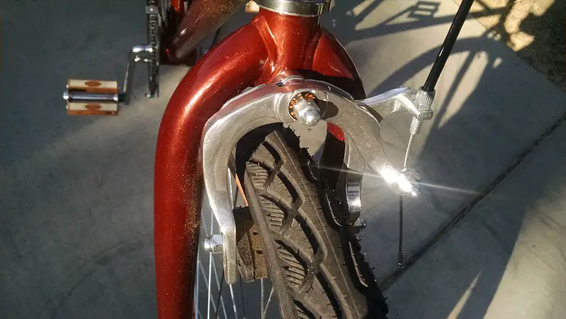

Front cantilever brake installed.

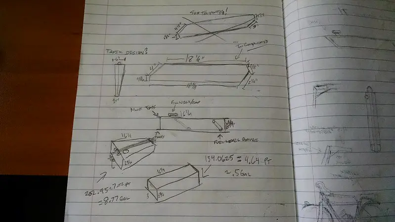

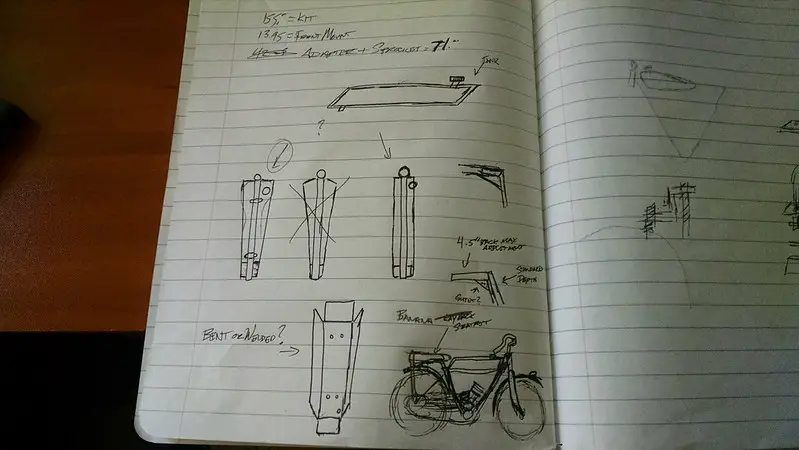

Tank has been designed.
Initial designs:
Secondary sketches/volume calculations/designed finalized? You can see some input from the DIY tank sticky. That fuel level gauge is an awesome design!
So far this is where I'm at.
I'll be designing/building the tank in my fabrication class (going to the local community college for welding/fabrication) out of stainless steel. I believe I'm going to TIG weld it. Depends on how well I can TIG once I finish the design. (also taking a TIG class this semester) If not I'll try to get away with MIG welding it if the gauge of steel is thick enough. Smallest gauge I can weld MIG would be 20ga.

Looks like a nice platform to do a build on... It shouldn't be too hard to make the stainless tank and I agree, TIG is the way to go, MIG will do it too but you can typically get much better looking welds with the TIG and the connections will be nice and strong.

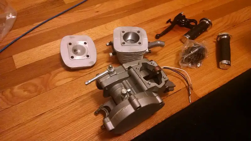

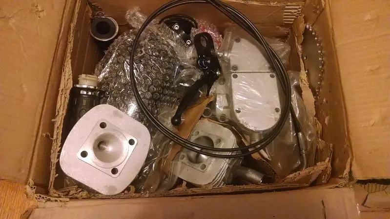

Kit came in today!! Which is sweet because the tracking number was given to me at like 5pm and it shipped yesterday.
Unboxing:
Engine is in pieces...
Complete kit:
My bro shot me some youtube vids of Fred's so I can put this badboy together.
I'm wondering though, since it's already apart, would it be a good idea to do a bit of porting on the intake and exhaust sides?
Any other mods I can do since it's already apart?

This would be a good time to clean up the ports but get as much info on it before jumping in because it's real easy to go from just right to a paper weight... there's a good amount of info on porting in the high performance section in here..
One of the things I would recommend would be to clean up any plating that overhangs into the port windows and chamfer all the port openings to prevent the plating from peeling, this is best done with a dremel but jeweler's files can be used.
If you got a dremel setup you can widen the exhaust port and intake port as well as smooth out the casting ridge in the transfer roofs as well as cut 5mm from the intake side of the bottom of the piston skirt. This will make good torque by going about 2mm wider on each side of the intake and exhaust ports along with the 5mm cutout on the piston skirt's intake side.
To get more rpm and top end power you would do the above plus raise the exhaust port roof by 1mm... you can go higher but this is about the point where you need to use a degree wheel and know how to calculate port duration. People in here including myself can help you here if you decide to go this far...
Another thing that'll boost power is to shave down the cylinder head if using a stock head, taking off 1mm from the head's mating surface will raise the compression ratio to a more respectable level... this is done with a sheet of sandpaper taped to a perfectly flat surface like a sheet of glass and running the head over the sandpaper in a circular motion. If you have a compression checker or can borrow one from a buddy or from autozone, you want the compression pressure to read 130 to 140 psi. Any more than 140 is where you may not be able to run 87 octane gas...
