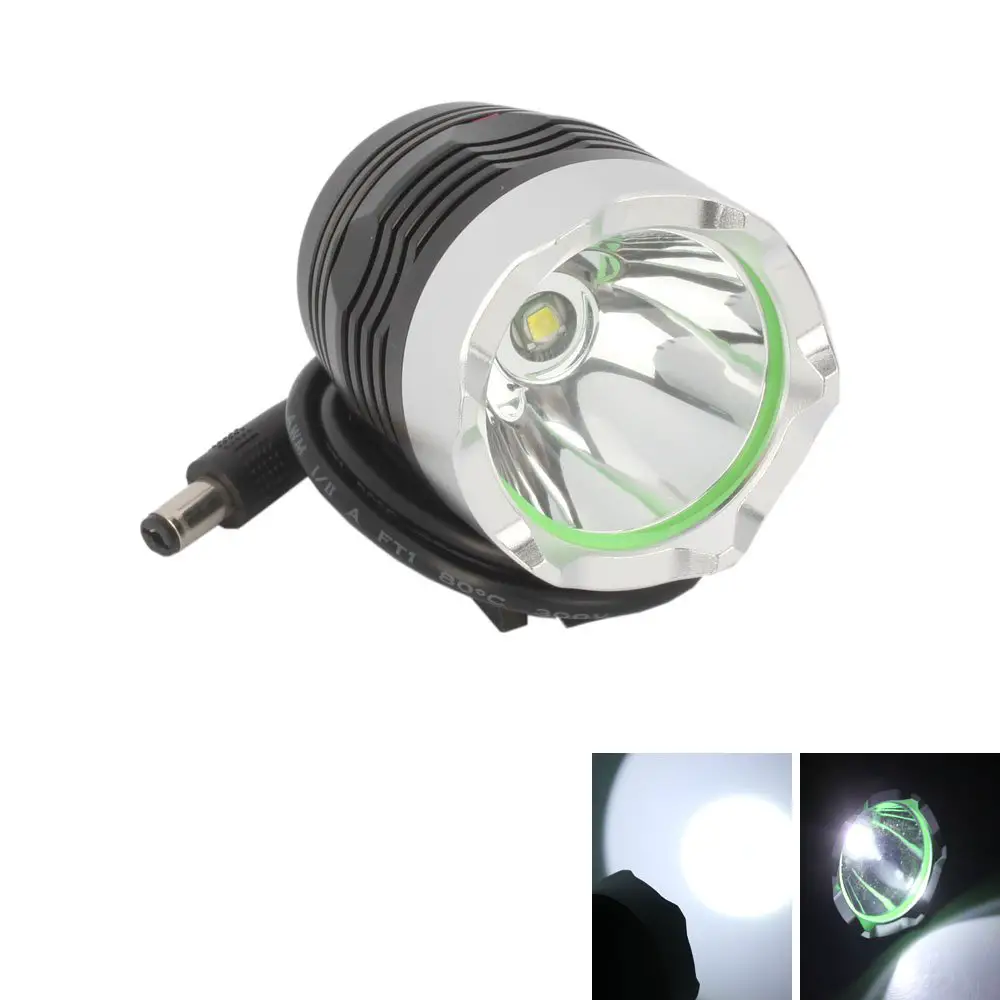

Hi KCVale, I know wot u mean. I've been using a small, 3 x AAA battery powered, 190 lumen LED flashlight with strobe feature clipped to the handle bars for this.
These are the $22 1200 Lumen 7.4V 4.4A quad 18650 Lithium Ion battery pack powered CREE XML T6 3 mode bike light with charger I use.
Just ordered 3 more actually.
http://www.amazon.com/CREE-Bicycle-Headlight-Files-Lumens/dp/B006Y1FK18
You might want to look into 18650 LI batteries, they are a little larger than a AA and pack anywhere from 1.8A to 3.5A at 3.7V each.
The pack in that light has two 2.2A series bats in 2 parallel rows for 7.4V and 4.4A
They are a good power source if you want to power super bright LED's which once again I know first hand to be one of the top three most important safety items for motorized bicycle riding with good brakes and a helmet.
