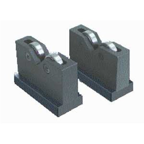

V-blocks are MUCH better because they are centerless (which is the only way you can check a crank's runout).
Unlubed, they tend to chaffe though, and lubed they tend to float a couple tenths as they turn, and then settle when they sit, so your runout reading has a bit of artifact in it.
Rollers are really the only way to do it right. You can make a set of roller blocks for about $40 in materials.

Wow what a great article about tuning up a lathe. Kind of blows my little mind really. That's how little I know. Kind of explains some inconsistances I've been seeing. I didn't understand what was going on.
A lathe, V Blocks, and a Roller are 3 different ways to do it, right?
